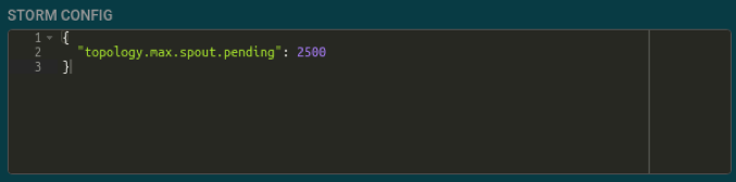

Set the Max Spout Pending parameter such that the maximum
number of unacked tuples in the topology is close to the Parser
Executor capacity (for example, ~0.950).
Setting the maximum number of unacked tupples to the Parser Executor capacity ensures that if there is a large spike in incoming events, the topology will not become overloaded. For example, to determine this value you can increase the producer events per second by a large amount and test various values for Max Spout Pending. The value can be set under the Storm settings of the relevant parser.

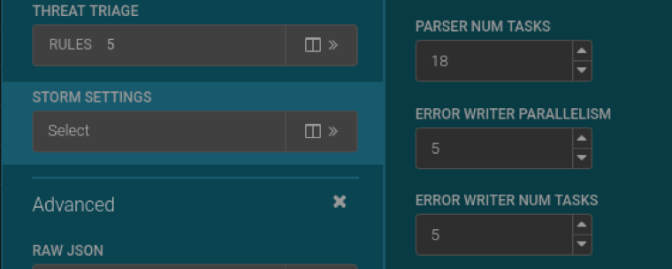

Set the Error Writer Parallelism and Num
Tasks values.
Generally, since a small number of errors is expected, it can be set quite low. There should be more than 3 for redundancy but going as high as 1 per worker may also be of benefit for even distribution.
