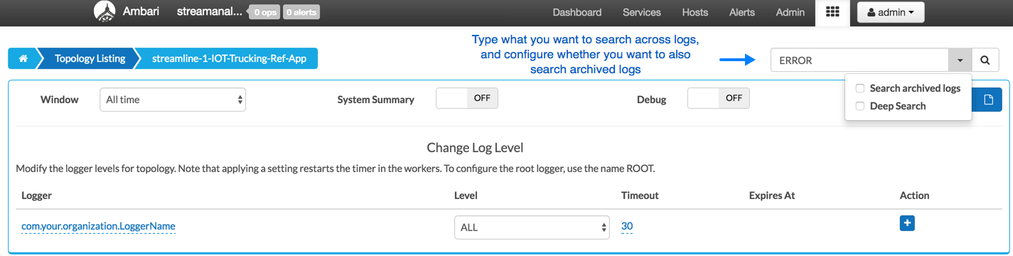

  1. Type your search string in the distributed log search text box:

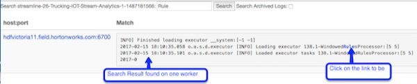

  2. Review the results.
  3. Click on the link to navigate to the exact location in the log file.
