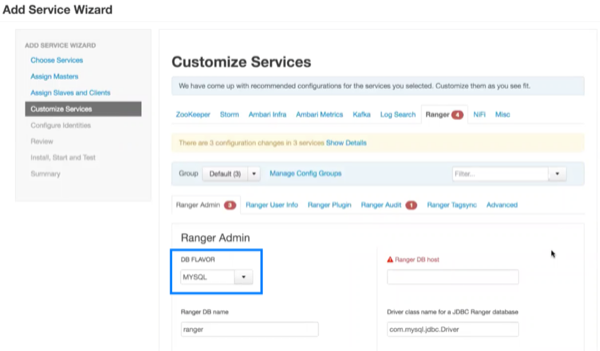

​Ranger Admin Settings
  1. On the Customize Services page, select the Ranger Admin tab, then use the DB Flavor drop-down to select the database type that you are using with Ranger.
  2. Enter the database server address in the Ranger DB Host box.

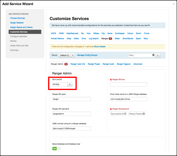

    The following images show examples of the DB settings for each Ranger database type.
    [Note]Note
    To test the DB settings, click Test Connection. If a Ranger database has not been pre-installed, Test Connection will fail even for a valid configuration.

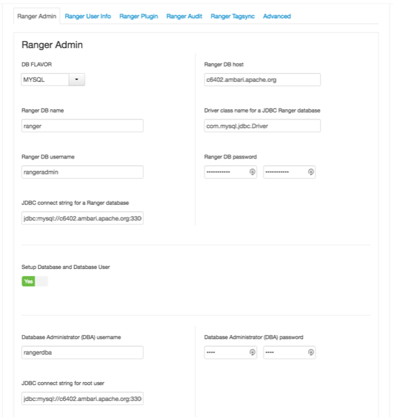

    MySQL

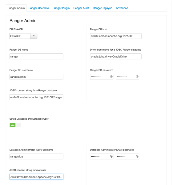

    Oracle -- if the Oracle instance is running with a Service name.

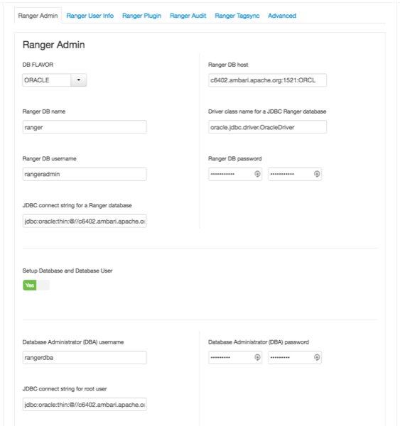

    Oracle -- if the Oracle instance is running with a SID.

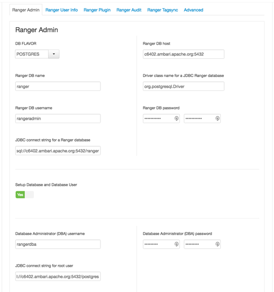

    PostgreSQL

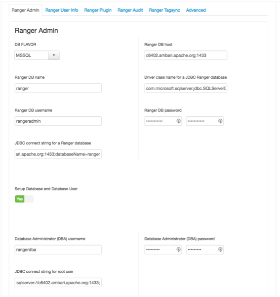

    MS SQL

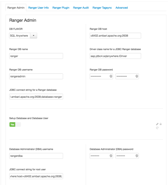

    SQL Anywhere
