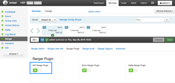

Use the following steps to enable the Ranger NiFi plugin.
  1. On the Ranger Configs page, select the Ranger Plugin tab.
  2. Under NiFi Ranger Plugin, select ON, then click Save in the black menu bar.
  3. A Save Configuration pop-up appears. Type in a note describing the changes you just made, then click Save.

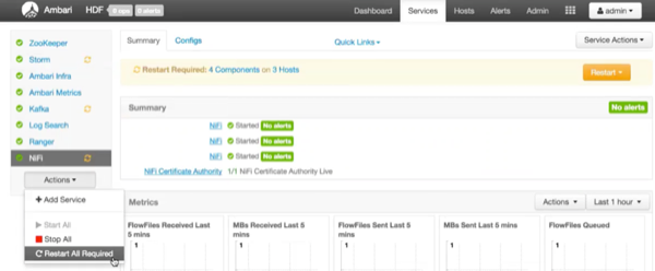

  6. From the left navigation menu click Actions, then Restart All Required to restart NiFi and any additional plugins you have enabled.
  7. Click Confirm Restart All on the confirmation pop-up to confirm the NiFi restart along with any other services requiring a restart.
  8. After your services restart, the Ranger plugin is enabled.
