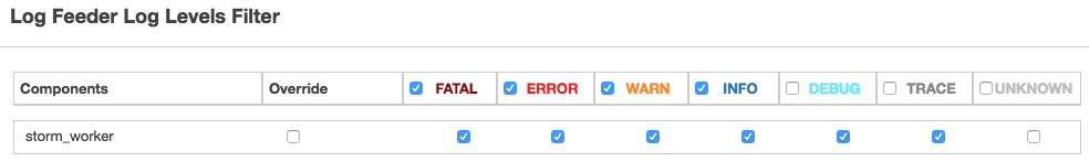

  1. To enable Log Search in SAM, perform the following actions in Ambari.
    1. In Ambari, select the Log Search service and select ‘Log Search UI’ from Quick Links
    2. Select the filter icon on the top right menu
    3. For the storm_worker component, configure the filter like the following and click Save.

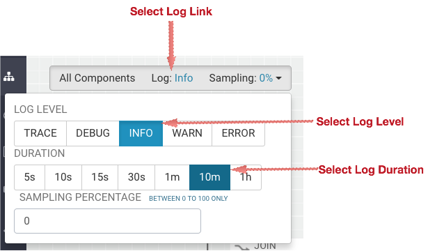

  2. In SAM, you can dynamically change the logging level. For example, in SAM view mode of an application, click on the Log link, select the log level and the duration you want that log level.

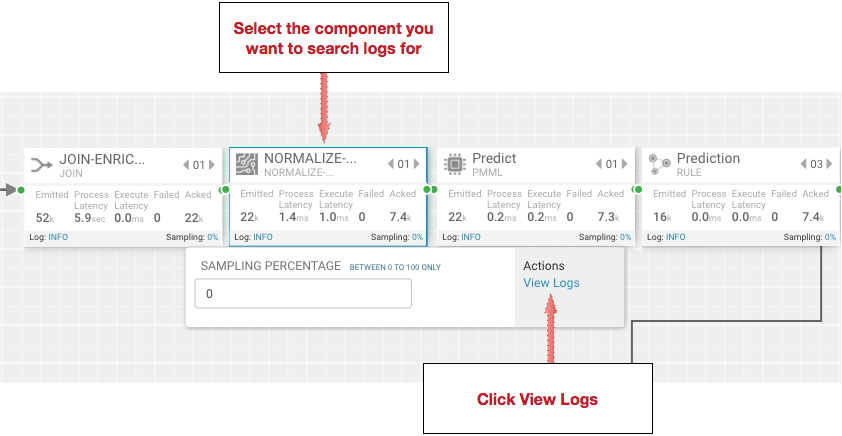

  3. Then click on the component you want to search logs for and under Actions select Logs.

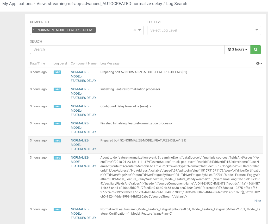

  4. This brings you to the Log Search page where you can search by component (s), log level(s) and search for strings using wildcard notation.
