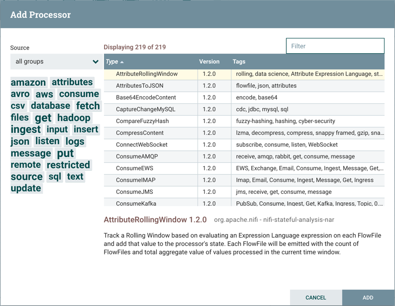

Processor: The Processor is the most commonly used component, as it is responsible for data ingress, egress, routing, and manipulating. There are many different types of Processors. In fact, this is a very common Extension Point in NiFi, meaning that many vendors may implement their own Processors to perform whatever functions are necessary for their use case. When a Processor is dragged onto the canvas, the user is presented with a dialog to choose which type of Processor to use:
In the top-right corner, the user is able to filter the list based on the Processor Type or the Tags associated with a Processor. Processor developers have the ability to add Tags to their Processors. These tags are used in this dialog for filtering and are displayed on the left-hand side in a Tag Cloud. The more Processors that exist with a particular Tag, the larger the Tag appears in the Tag Cloud. Clicking a Tag in the Cloud will filter the available Processors to only those that contain that Tag. If multiple Tags are selected, only those Processors that contain all of those Tags are shown. For example, if we want to show only those Processors that allow us to ingest files, we can select both the files Tag and the ingest Tag:
Restricted components will be marked with a icon next to their name. These are components that can be used to execute arbitrary unsanitized code provided by the operator through the NiFi REST API/UI or can be used to obtain or alter data on the NiFi host system using the NiFi OS credentials. These components could be used by an otherwise authorized NiFi user to go beyond the intended use of the application, escalate privilege, or could expose data about the internals of the NiFi process or the host system. All of these capabilities should be considered privileged, and admins should be aware of these capabilities and explicitly enable them for a subset of trusted users.
Before a user is allowed to create and modify restricted components they must be granted access to restricted components. For more information refer to Accessing the UI with Multi-Tenant Authorization.
Clicking the Add button or double-clicking on a Processor Type will add the selected Processor to the canvas at the location that it was dropped.

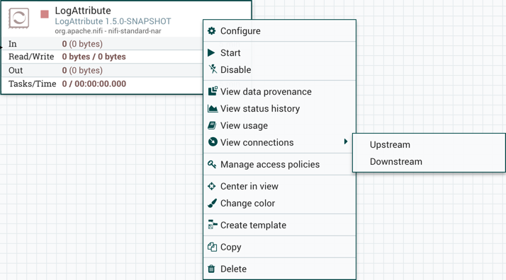

Once you have dragged a Processor onto the canvas, you can interact with it by right-clicking on the Processor and selecting an option from the context menu. The options available to you from the context menu vary, depending on the privileges assigned to you.
While the options available from the context menu vary, the following options are typically available when you have full privileges to work with a Processor:
  • Configure: This option allows the user to establish or change the configuration of the Processor (see Configuring a Processor).
For Processors, Ports, Remote Process Groups, Connections and Labels, it is possible to open the configuration dialog by double-clicking on desired component.
  • Start or Stop: This option allows the user to start or stop a Processor; the option will be either Start or Stop, depending on the current state of the Processor.
  • Enable or Disable: This option allows the user to enable or enable a Processor; the option will be either Enable or Disable, depending on the current state of the Processor.
  • View data provenance: This option displays the NiFi Data Provenance table, with information about data provenance events for the FlowFiles routed through that Processor (see Data Provenance).
  • View status history: This option opens a graphical representation of the Processor's statistical information over time.
  • View usage: This option takes the user to the Processor's usage documentation.
  • View connections→Upstream: This option allows the user to see and "jump to" upstream connections that are coming into the Processor. This is particularly useful when processors connect into and out of other Process Groups.
  • View connections→Downstream: This option allows the user to see and "jump to" downstream connections that are going out of the Processor. This is particularly useful when processors connect into and out of other Process Groups.
  • Center in view: This option centers the view of the canvas on the given Processor.
  • Change color: This option allows the user to change the color of the Processor, which can make the visual management of large flows easier.
  • Create template: This option allows the user to create a template from the selected Processor.
  • Copy: This option places a copy of the selected Processor on the clipboard, so that it may be pasted elsewhere on the canvas by right-clicking on the canvas and selecting Paste. The Copy/Paste actions also may be done using the keystrokes Ctrl-C (Command-C) and Ctrl-V (Command-V).
  • Delete: This option allows the DFM to delete a Processor from the canvas.

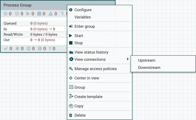

Process Group: Process Groups can be used to logically group a set of components so that the dataflow is easier to understand and maintain. When a Process Group is dragged onto the canvas, the DFM is prompted to name the Process Group. All Process Groups within the same parent group must have unique names. The Process Group will then be nested within that parent group.
Once you have dragged a Process Group onto the canvas, you can interact with it by right-clicking on the Process Group and selecting an option from context menu.The options available to you from the context menu vary, depending on the privileges assigned to you.
While the options available from the context menu vary, the following options are typically available when you have full privileges to work with the Process Group:
  • Configure: This option allows the user to establish or change the configuration of the Process Group.
  • Variables: This option allows the user to create or configure variables within the NiFi UI.
  • Enter group: This option allows the user to enter the Process Group.
It is also possible to double-click on the Process Group to enter it.
  • Start: This option allows the user to start a Process Group.
  • Stop: This option allows the user to stop a Process Group.
  • View status history: This option opens a graphical representation of the Process Group's statistical information over time.
  • View connections→Upstream: This option allows the user to see and "jump to" upstream connections that are coming into the Process Group.
  • View connections→Downstream: This option allows the user to see and "jump to" downstream connections that are going out of the Process Group.
  • Center in view: This option centers the view of the canvas on the given Process Group.
  • Group: This option allows the user to create a new Process Group that contains the selected Process Group and any other components selected on the canvas.
  • Create template: This option allows the user to create a template from the selected Process Group.
  • Copy: This option places a copy of the selected Process Group on the clipboard, so that it may be pasted elsewhere on the canvas by right-clicking on the canvas and selecting Paste. The Copy/Paste actions also may be done using the keystrokes Ctrl-C (Command-C) and Ctrl-V (Command-V).
  • Delete: This option allows the DFM to delete a Process Group.

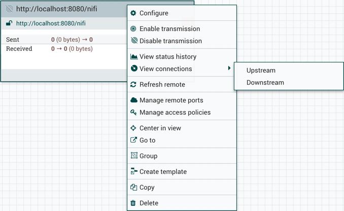

Remote Process Group: Remote Process Groups appear and behave similar to Process Groups. However, the Remote Process Group (RPG) references a remote instance of NiFi. When an RPG is dragged onto the canvas, rather than being prompted for a name, the DFM is prompted for the URL of the remote NiFi instance. If the remote NiFi is a clustered instance, the URL that should be used is the URL of any NiFi instance in that cluster. When data is transferred to a clustered instance of NiFi via an RPG, the RPG will first connect to the remote instance whose URL is configured to determine which nodes are in the cluster and how busy each node is. This information is then used to load balance the data that is pushed to each node. The remote instances are then interrogated periodically to determine information about any nodes that are dropped from or added to the cluster and to recalculate the load balancing based on each node's load. For more information, see the section on Site-to-Site.
Once you have dragged a Remote Process Group onto the canvas, you can may interact with it by right-clicking on the Remote Process Group and selecting an option from context menu. The options available to you from the context menu vary, depending on the privileges assigned to you.
While the options available from the context menu vary, the following options are typically available when you have full privileges to work with the Remote Process Group:
  • Configure: This option allows the user to establish or change the configuration of the Remote Process Group.
  • Enable transmission: Makes the transmission of data between NiFi instances active (see Remote Process Group Transmission).
  • Disable transmission: Disables the transmission of data between NiFi instances.
  • View status history: This option opens a graphical representation of the Remote Process Group's statistical information over time.
  • View connections→Upstream: This option allows the user to see and "jump to" upstream connections that are coming into the Remote Process Group.
  • View connections→Downstream: This option allows the user to see and "jump to" downstream connections that are going out of the Remote Process Group.
  • Refresh remote: This option refreshes the view of the status of the remote NiFi instance.
  • Group: This option allows the user to create a new Process Group that contains the selected Remote Process Group and any other components selected on the canvas.
  • Manage remote ports: This option allows the user to see input ports and/or output ports that exist on the remote instance of NiFi that the Remote Process Group is connected to. Note that if the Site-to-Site configuration is secure, only the ports that the connecting NiFi has been given accessed to will be visible.
  • Center in view: This option centers the view of the canvas on the given Remote Process Group.
  • Go to: This option opens a view of the remote NiFi instance in a new tab of the browser. Note that if the Site-to-Site configuration is secure, the user must have access to the remote NiFi instance in order to view it.
  • Group: This option allows the user to create a Process Group containing the selected Remote Process Group.
  • Create template: This option allows the user to create a template from the selected Remote Process Group.
  • Delete: This option allows the DFM to delete a Remote Process Group from the canvas.

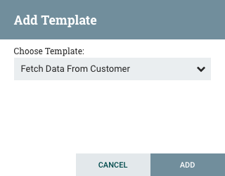

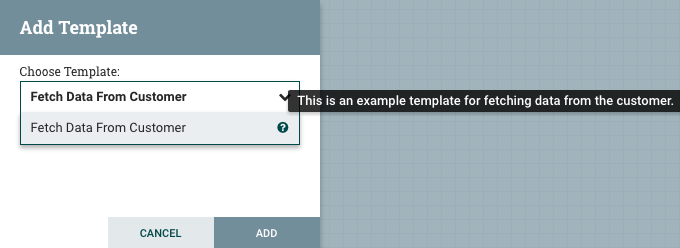

Template: Templates can be created by DFMs from sections of the flow, or they can be imported from other dataflows. These Templates provide larger building blocks for creating a complex flow quickly. When the Template is dragged onto the canvas, the DFM is provided a dialog to choose which Template to add to the canvas:
Clicking the drop-down box shows all available Templates. Any Template that was created with a description will show a question mark icon, indicating that there is more information. Hovering over the icon with the mouse will show this description:
