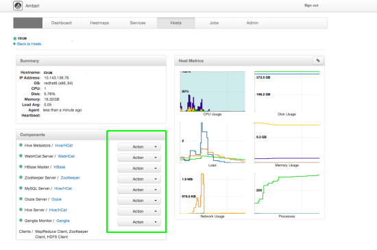

To see more detailed information on a specific host, click the host FDQN. The Host Details screen opens.
Use the Action dropdowns, outlined in green above, to stop or start a service component running on that host.
