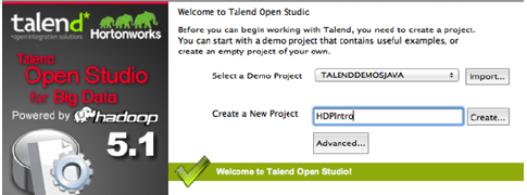

 3.1.2. Step 2: Create a new project
  • Provide a project name (for example, HDPIntro) and click the “Create” button.
  • Click “Finish” on the “New Project” dialog
  • Select the newly created project and click “Open”.

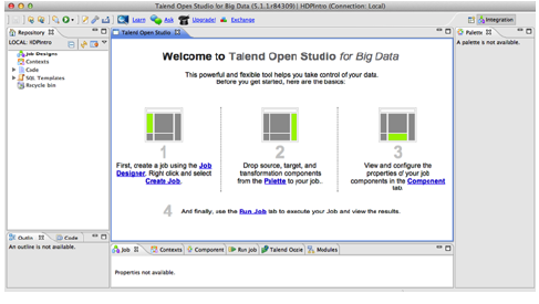

  • The “Connect To TalendForge” dialog appears, you can choose to register or click “Skip” to continue.
  • You should now see the progress information bar and a welcome window. Wait for the application to initialize and then click “Start now!” to continue. Talend Open Studio (TOS) main window appears and is now ready for use.

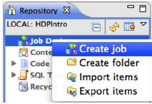

  • In the Repository tree view, right-click the “Job Designs” node.
  • From the contextual menu, select “Create job”.
  • In the “New Job” wizard provide a name (for example HDPJob) and click “Finish”.
  • An empty design workspace corresponding to the Job name opens up.

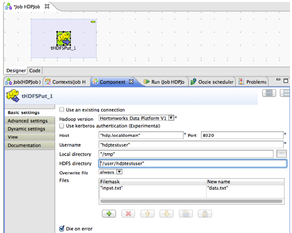

 3.2.3. Step 3: Build the job
Jobs are composed of components that are available in the Palette.
  • Expand the “Big Data” tab in the Palette.
  • Click on the component tHDFSPut and click on the design workspace to drop this component.
  • Double-click tHDFSPut to define component in its Basic Settings view.
  • Set the values in the Basic Settings corresponding to your HDP cluster (see the screenshot given below):

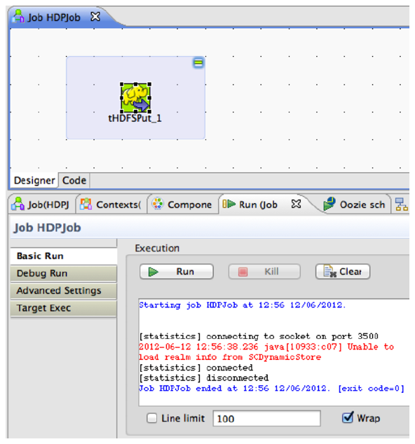

 3.2.4. Step 4: Run the job
You now have a working job. You can run it by clicking the green play icon.
You should see the following:

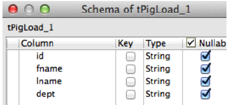

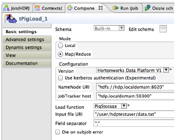

 3.3.2. Step 2: Define basic settings for Pig component
  • Double-click tPigLoad component to define its Basic Settings.
  • Click the “Edit Schema” button (“…” button). Define the schema of the input data as shown below and click OK:
  • Provide the values for the mode, configuration, NameNode URI, JobTracker host, load function, and input file URI fields as shown.
    [Important]Important
    Ensure that the NameNode URI and the JobTracker host corresponds to accurate values available in your HDP cluster. The Input File URI corresponds to the path where we imported the input.txt file in previous section.

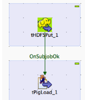

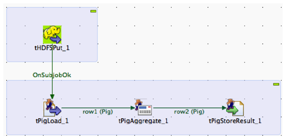

 3.3.3. Step 3: Connect the Pig and HDFS components
Connect the Pig and HDFS components to define the workflow. To connect the two components:
  • Right-click the source component (tHDFSPut) on your design workspace.
  • From the contextual menu, select Trigger -> On Subjob Ok.
  • Click the target component (tPigLoad).

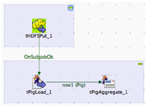

 3.3.4. Step 4: Add and connect Pig aggregate component
  • Add the component tPigAggregate next to tPigLoad.
  • From the contextual menu, right-click on tPigLoad and select Row -> Pig Combine.
  • Click on tPigAggregate.

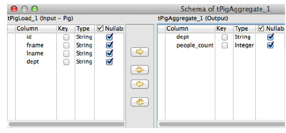

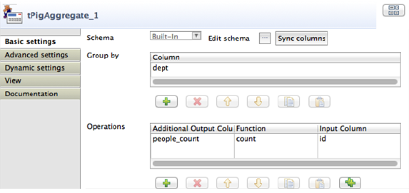

 3.3.5. Step 5: Define basic settings for Pig Aggregate component
  • Double-click tPigAggregate to define the component in its Basic Settings.
  • Click on the “Edit schema” button and define the output schema as shown below:
 3.3.6. Step 6: Define aggregation function for the data
  • Add a column to “Group by”, choose “dept”.
  • In the Operations table, choose the “people_count” in the Additional Output column, function as “count” and input column “id” as shown:

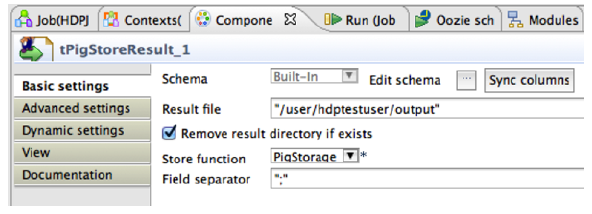

 3.3.7. Step 7: Add and connect Pig data storage component
  • Add the component tPigStoreResult next to tPigAggregate.
  • From the contextual menu, right-click on tPigLoad, select Row -> Pig Combine and click on tPigStoreResult.
 3.3.8. Step 8: Define basic settings for data storage component
  • Double-click tPigStoreResult to define the component in its Basic Settings view.
  • Specify the result directory on HDFS as shown:
