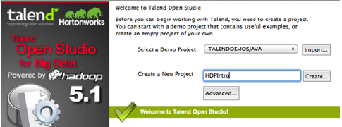

  2. Create a new project.
    1. Provide a project name (for example, HDPIntro) and click the Create button.
    2. Click Finish on the New Project dialog.
    3. Select the newly created project and click Open.

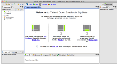

    4. The Connect To TalendForge dialog appears, you can choose to register or click Skip to continue.
    5. You should now see the progress information bar and a welcome window. Wait for the application to initialize and then click Start now! to continue. Talend Open Studio (TOS) main window appears and is now ready for use.

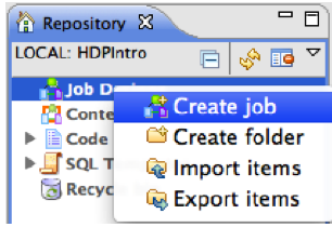

  1. Create a new job.
    1. In the Repository tree view, right-click the “Job Designs” node.
    2. From the contextual menu, select “Create job”.
    3. In the “New Job” wizard provide a name (for example HDPJob) and click “Finish”.
    4. An empty design workspace corresponding to the Job name opens up.

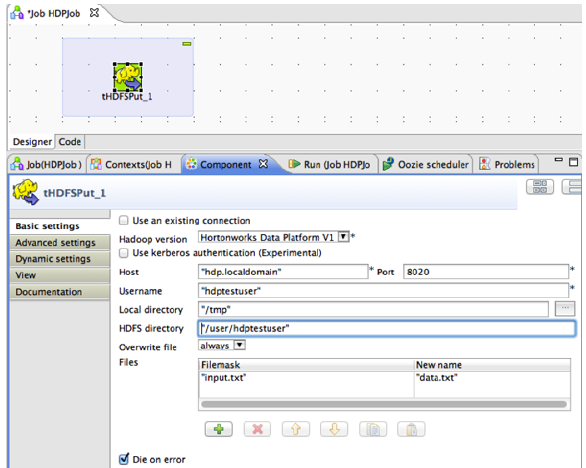

    2. Click on the component tHDFSPut and click on the design workspace to drop this component.
    3. Double-click tHDFSPut to define component in its Basic Settings view.
    4. Set the values in the Basic Settings corresponding to your HDP cluster (see the screenshot given below):

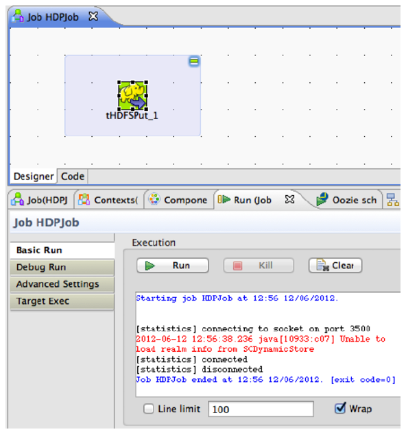

  4. Run the job. You now have a working job. You can run it by clicking the green play icon.
    You should see the following:

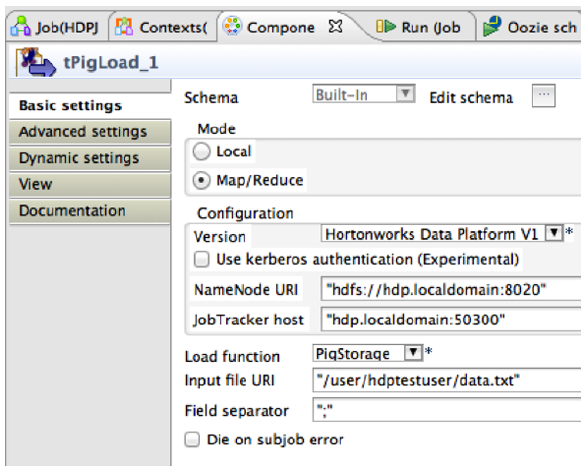

  2. Define basic settings for Pig component.

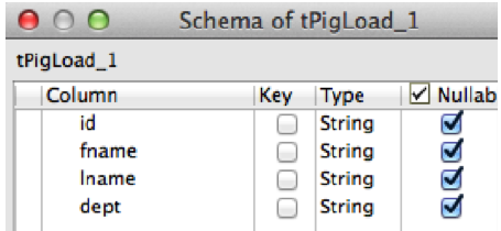

    1. Double-click tPigLoad component to define its Basic Settings.
    2. Click the Edit Schema button (“…” button). Define the schema of the input data as shown below and click OK:
    3. Provide the values for the mode, configuration, NameNode URI, JobTracker host, load function, and input file URI fields as shown.
      [Important]Important
      Ensure that the NameNode URI and the JobTracker host corresponds to accurate values available in your HDP cluster. The Input File URI corresponds to the path of the previously imported input.txt file.

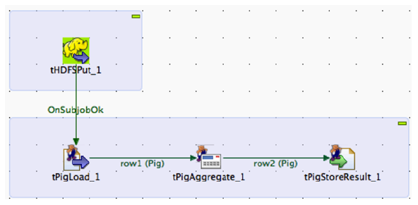

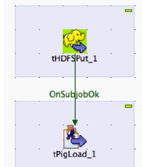

  3. Connect the Pig and HDFS components to define the workflow.
    1. Right-click the source component (tHDFSPut) on your design workspace.
    2. From the contextual menu, select Trigger -> On Subjob Ok.
    3. Click the target component (tPigLoad).

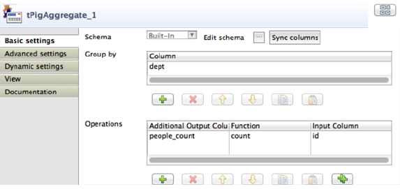

  5. Define basic settings for Pig Aggregate component.

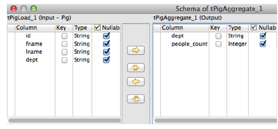

    1. Double-click tPigAggregate to define the component in its Basic Settings.
    2. Click on the “Edit schema” button and define the output schema as shown below:
  6. Define aggregation function for the data.
    1. Add a column to Group by, choose dept.
    2. In the Operations table, choose the people_count in the Additional Output column, function as count and input column id as shown:

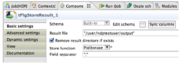

  7. Add and connect Pig data storage component
    1. Add the component tPigStoreResult next to tPigAggregate.
    2. From the contextual menu, right-click on tPigLoad, select Row -> Pig Combine and click on tPigStoreResult.
  8. Define basic settings for data storage component.
    1. Double-click tPigStoreResult to define the component in its Basic Settings view.
    2. Specify the result directory on HDFS as shown:
