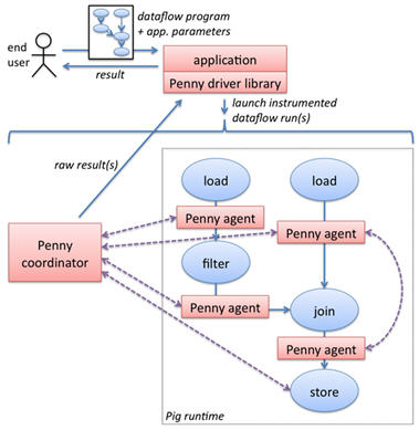

How it Works
Before you can create a tool, you need to understand how Penny instruments Pig scripts (called "dataflow programs" in the following diagram).
As shown in the diagram, Penny inserts one or more monitor agents (called "Penny agent" in the diagram) between steps of the Pig script, which observe data flowing between the Pig script steps. Monitor agents run arbitrary Java code as needed for your tool, which has access to some primitives for tagging records and communicating with other agents and with a central coordinator process (called "Penny coordinator" in the diagram). The coordinator also runs arbitrary code defined by your tool.
The whole thing is kicked off by the tool's Main program (called "application" in the diagram), which receives instructions from the user (e.g. "please figure out why this Pig script keeps crashing"), launches one or more runs of the Pig script instrumented with monitor agents, and reports the outcome back to the user (e.g. "the crash appears to be caused by one of these records: ...").
