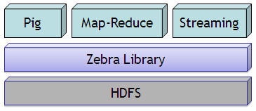

Zebra is an access path library for reading and writing data in a column-oriented fashion. Zebra functions as an abstraction layer between your client application and data on the Hadoop Distributed File System (HDFS). Data is written to HDFS using Zebra’s TableStore class. Data is read from HDFS using Zebra’s TableLoad class. Zebra supports client applications written as Pig, MapReduce, or streaming jobs. Keep in mind that Zebra works with Zebra tables; you cannot use Zebra to process text or sequence files.
