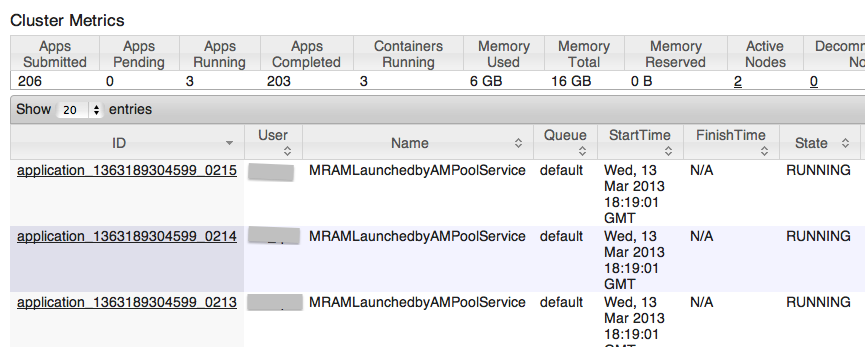

hive.Validate if Tez AM is enabled successfully.
Browse to the ResourceManager (RM) web user interface at
http://.$resourcemanager.full.hostname:8088/clusterYour RM web UI should have the following status message as shown in the screenshot below:
![[Note]](../common/images/admon/note.png)
Note If any of the applications remain in an ACCEPTED or SUBMITTED state, this implies that your existing configuration is overutilizing the cluster resources.
Ensure that you tune the configuration parameters as instructed here to avoid cluster over-utilization and restart the service.
