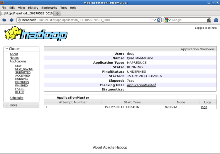

If you navigate back to the main Running Applications window and click the
application_138… link, the Application status page appears.
This page provides information similar to that on the Running Applications page,
but only for the selected job.
Clicking the ApplicationMaster link on the Application status page opens the MapReduce Application page shown in the following figure. Note that the link to the ApplicationMaster is also on the main Running Applications screen in the last column.

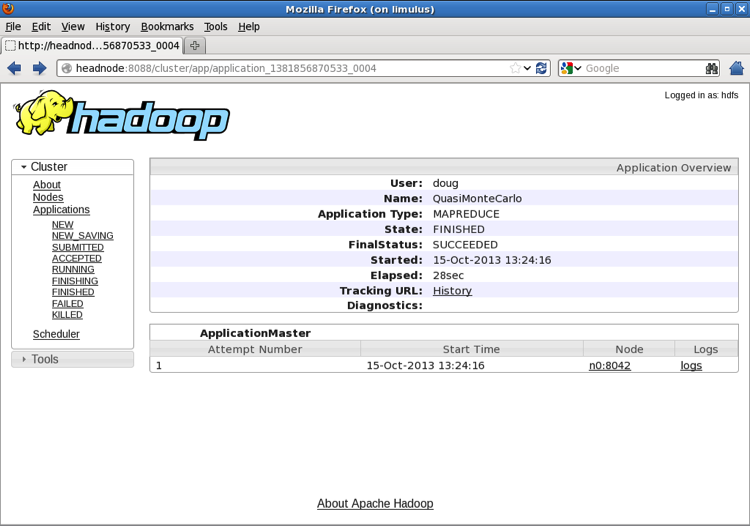

The MapReduce Job page provides more detail about the status of the job. When the job is finished, the page is updated as shown in the following figure:

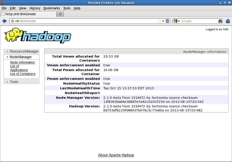

If you click the Node used to run the ApplicationMaster (n0:8042
above), a NodeManager summary page appears, as shown in the following figure.
Again, the NodeManager only tracks Containers. The actual tasks that the
Containers run is determined by the ApplicationMaster.
