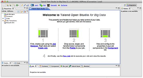

Talend displays the progress information bar. When progress is complete, Talend displays a Welcome window.
Wait for the application to initialize, then click . Talend displays the main Talend Open Studio (TOS) window.

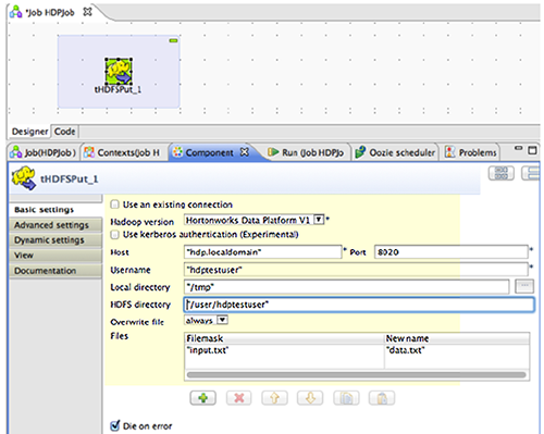

Expand the tab in the Palette.
Click the
tHDFSPutcomponent, then select the design workspace to drop this component.To define the component in its Basic Settings view, double-click tHDFSPut.
Set the values in the Basic Settings corresponding to your HDP cluster:

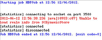

You now have a working job.
To run the job, click Play. Talend displays something similar to the following:
Verify the import operation. From the gateway machine or the HDFS client, open a console window and execute:
hadoop dfs -ls /user/testuser/data.txt
At your terminal window, Talend displays:
Found 1 items -rw-r--r-- 3 testuser testuser 252 2012-06-12 12:52 /user/ testuser/data.txt
This message indicates that the local file was successfully created in your Hadoop cluster.

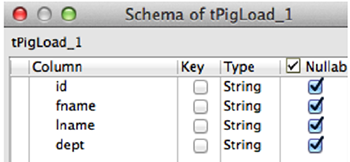

Define basic settings for the Pig component.
To define the component's basic settings, double-click tPigLoad.
Click . Define the schema of the input data as shown below, then click :

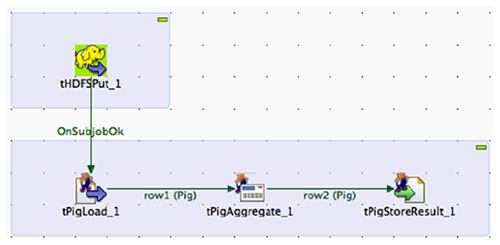

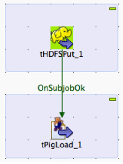

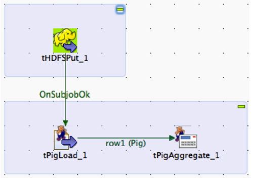

Connect the Pig and HDFS components to define the workflow.
Right-click the source component (tHDFSPut) on your design workspace.
From the contextual menu, select Trigger -> On Subjob Ok.
Click the target component (tPigLoad).
Add and connect Pig aggregate component.
Add the component tPigAggregate next to tPigLoad.
From the contextual menu, right-click on tPigLoad and select -> Pig Combine.
Click on tPigAggregate.

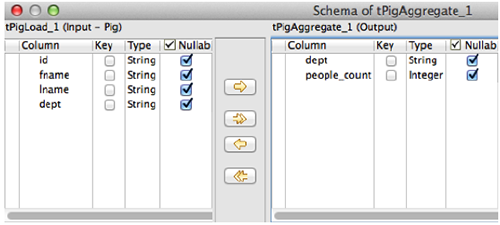

Define basic settings for the Pig Aggregate component.
Double-click tPigAggregate to define the component in its Basic Settings.
Click on the “Edit schema” button and define the output schema as shown below:
Define aggregation function for the data.
For
Group byadd a Column and selectdept.In the Operations table, choose the
people_countin the Additional Output column, function ascountand input columnidas shown:
Add and connect Pig data storage component
Add the component
tPigStoreResultnext totPigAggregate.From the contextual menu, right-click on
tPigLoad, select Row -> Pig Combine and click ontPigStoreResult.

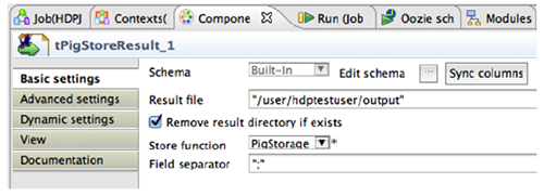

Define basic settings for the data storage component.
Double-click tPigStoreResult to define the component in its Basic Settings view.
Specify the result directory on HDFS as shown:
