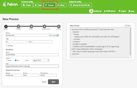

  1. At the top of the Falcon web UI page, click Process.
    Figure 2.6. New Process Configuration Dialog
  2. On the New Process page, specify the following values:
    Table 2.3. General Process Configuration Values
    Value
    Description
    Name
    Name of the process entity.
    Tags
    Business labels, such as "Finance." There is no input validation on this field, so there can be duplicates, which is resolved in environments with Apache Atlas integration. See Configuring, Using, and Managing the Metadata Store (Atlas).
    Workflow
    Specify a Name for the workflow, which Engine it uses, and the Path to the workflow engine. For example, if you are using a Pig script to define the workflow, you can set the Path to /apps/clickstream/clean-script.pig
    Access Control List
    Specify the HDFS access permissions. Required for HDFS.
