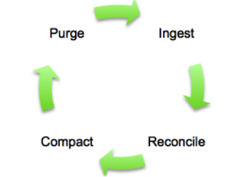

Use the following steps to incrementally update Hive tables from operational database systems:
  1. Ingest: Complete data movement from the operational database (base_table) followed by change or update of changed records only (incremental_table).
  2. Reconcile: Create a single view of the base table and change records (reconcile_view) to reflect the latest record set.
  3. Compact: Create a reporting table (reporting_table) from the reconciled view.
  4. Purge: Replace the base table with the reporting table contents and delete any previously processed change records before the next data ingestion cycle, which is shown in the following diagram.
Figure 1.3. Data Ingestion Lifecycle

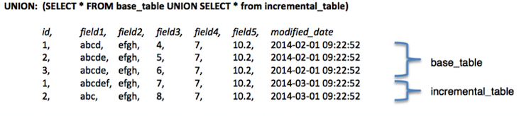

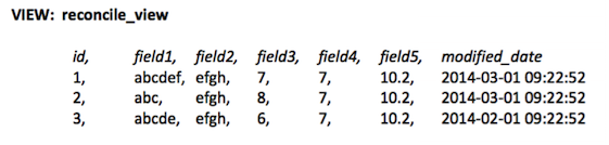

  2. Reconcile or merge the data.
    Create a view that uses UNION ALL to merge the data and reconcile the base table records with the new records:
    CREATE VIEW reconcile_view AS
    SELECT t1.* FROM
        (SELECT * FROM base_table
         UNION ALL
         SELECT * from incremental_table) t1
    JOIN
        (SELECT id, max(modified_date) max_modified FROM
             UNION ALL
         GROUP BY id) t2
    ON t1.id = t2.id AND t1.modified_date = t2.max_modified;
    EXAMPLES:
      Figure 1.4. Dataset after the UNION ALL Command Is Run
      Figure 1.5. Dataset in the View
      [Note]Note
      In the reconcile_view only one record exists per primary key, which is shown in the id column. The values displayed in the id column correspond to the latest modification date that is displayed in the modified_date column.
