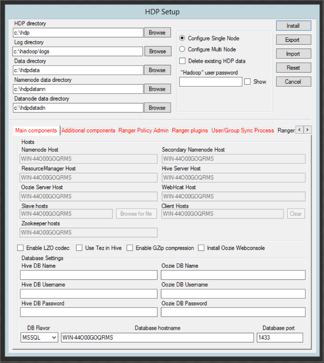

You can define cluster properties with the HDP Setup Interface or define them manually (described in the next subsection). If you use the HDP Setup Interface you can either export the configuration and use it to deploy HDP from the command line (or within a script), or you can start deployment from the Setup Interface itself.
To start the Setup Interface, enter the following command at the command prompt:
runas /user:administrator "msiexec /i hdp-2.3.4.7.winpkg.msi MSIUSEREALADMINDETECTION=1"
The HDP Setup form displays.
(The following image shows the form with the Main components tab selected.)
