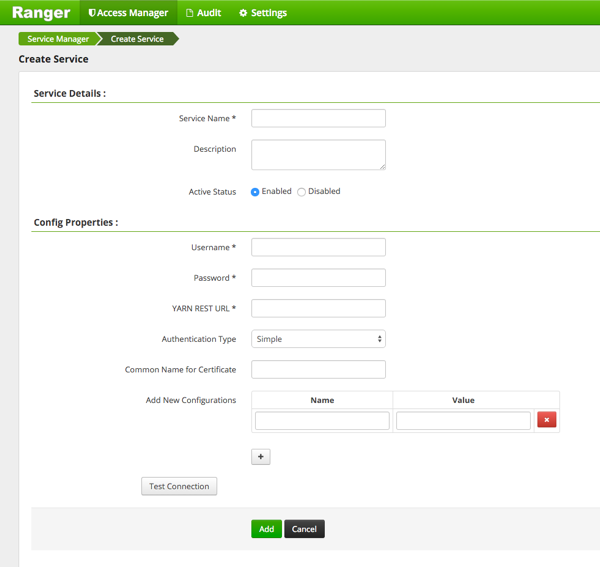

Use the following steps to add a service to YARN:
  1. On the Service Manager page, click the + next to YARN.
    The Create Service page appears.
    YARN Create Service page
  2. Enter the following information on the Create Service page:
    Table 3.35. Service Details
    Field name
    Description
    Service Name
    The name of the service; required when configuring agents.
    Description
    A description of the service.
    Active Status
    Enabled or Disabled.
    Table 3.36. Config Properties
    Field name
    Description
    Username
    The end system username that can be used for connection.
    Password
    The password for the username entered above.
    YARN REST URL
    Http or https://RESOURCEMANAGER_FQDN:8088.
    Authentication Type
    The type of authorization in use, as noted in the hadoop configuration file core-site.xml; either simple or Kerberos. (Required only if authorization is enabled).
    This field was formerly named hadoop.security.authorization.
    Common Name For Certificate
    The name of the certificate.
    This field is interchangeably named Common Name For Certificate and Ranger Plugin SSL CName in Create Service pages.
    Add New Configurations
    Add any other new configuration(s).
  3. Click Test Connection.
    Test Connection
  4. Click Add.
    the green Add button
