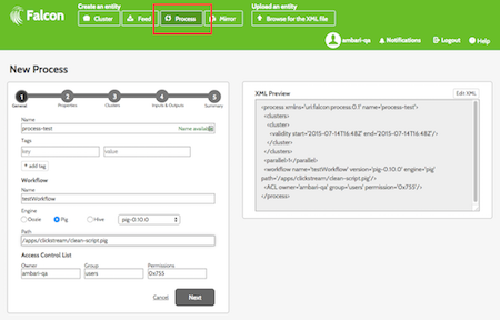

  1. At the top of the Falcon web UI page, click Process.
    Figure 2.6. New Process Configuration Dialog
  2. On the New Process page, specify the following values:

    Name
    Name of the process entity.
    Tags
    Business labels, such as "Finance." There is no input validation on this field, so there can be duplicates, which is resolved in environments with Apache Atlas integration. See Configuring, Using, and Managing the Metadata Store (Atlas).
    Workflow
    Specify a Name for the workflow, which Engine it uses, and the Path to the workflow engine. For example, if you are using a Pig script to define the workflow, you can set the Path to /apps/clickstream/clean-script.pig
    Notification
    Enables email notifications that are sent when the process instance completes. Specify the email address where you want notifications to be sent. For example, jdoe@xyz.com.
    Access Control List
    Specify the HDFS access permissions. Required for HDFS.
