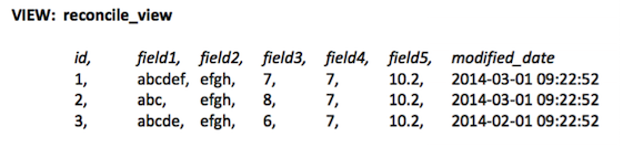

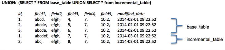

    EXAMPLES:
      Figure 1.4. Dataset after the UNION ALL Command Is Run
      Figure 1.5. Dataset in the View
      [Note]Note
      In the reconcile_view only one record exists per primary key, which is shown in the id column. The values displayed in the id column correspond to the latest modification date that is displayed in the modified_date column.
