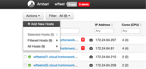

  1. Open Ambari in a browser and click the Hosts tab.
  2. On the Hosts page, click Actions, and select Add New Hosts:
    Figure 2.2. Add New Hosts with Ambari
  3. Follow the Add Host Wizard instructions.

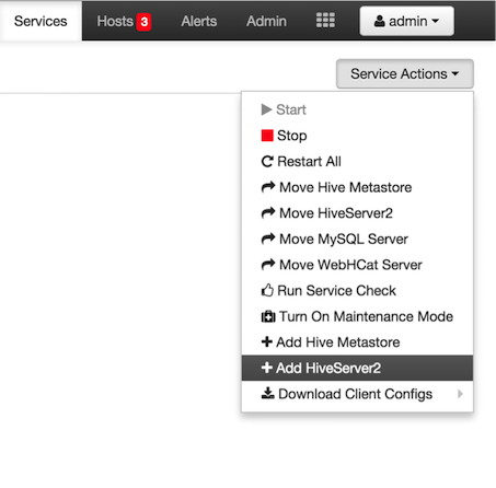

  6. On the upper right side of the Hive Services page, click Service Actions, and select Add HiveServer2:
    Figure 2.3. Add HiveServer2 with Ambari
  7. In the Confirmation dialog box, select the host that you added in Steps 1 -3, and click Confirm Add.
    The progress of adding the HS2 is displayed in the Background Operation Running dialog box. Click OK when it is finished to dismiss the dialog box.
