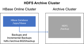

​Backup within a Cluster
Backup-and-restore within the same cluster is only appropriate for testing. This strategy is not suitable for production unless the underlying HDFS layer is backed up and is reliably recoverable.
Figure 5.4. Intracluster Backup

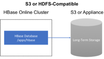

​Backup to the Cloud or a Storage Vendor
Another approach to safeguarding HBase incremental backups is to store the data on provisioned, secure servers that belong to third-party vendors and that are located off-site. The vendor can be a public cloud provider or a storage vendor who uses a Hadoop-compatible file system, such as S3 and other HDFS-compatible destinations.
Figure 5.6. Backup to Vendor Storage Solutions
