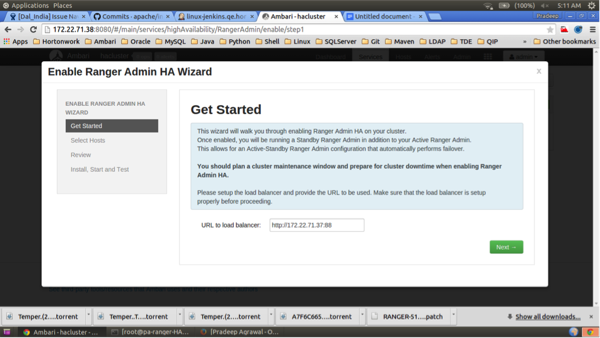

  16. Now you can enable Ranger Admin HA using Ambari. On the Ambari dashboard of the first Ranger host, select Services > Ranger, then select Service Actions > Enable Ranger Admin HA to launch the Enable Ranger Admin HA Wizard.
  17. On the Get Started page, enter the load-balancer URL and port number (in this example, 172.22.71.37:88), then click Next.

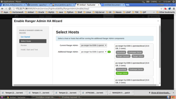

  18. On the Select Hosts page, confirm the host assignments, then click Next.

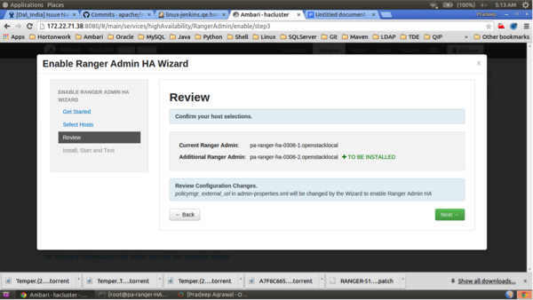

  19. Check the settings on the Review page, then click Next.

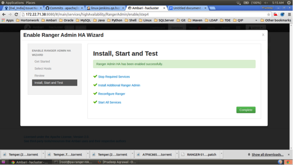

  20. Click Complete on the Install, Start, and Test page to complete the installation.

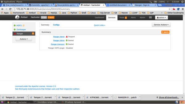

  21. When the installation is complete, the Ranger Admin instances are listed on the Ranger Summary page. Select Actions > Restart All Required to restart all services that require a restart.
    [Note]Note
    For Oracle, clear the Setup DB and DB user check box under "Advanced ranger-env" to avoid DB setup.

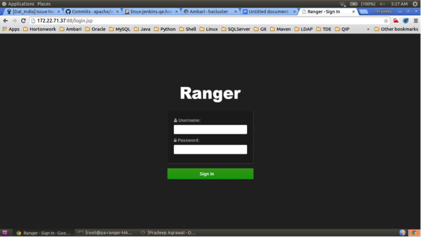

  22. To test the load-balancer and Ranger HA configuration, select Ranger > Service Actions > Stop on one of the Ranger hosts.
  23. Use a browser to check the load-balancer host URL (with port). You should see the Ranger Admin page.

  26. Run the following command to restart the httpd server:
    /usr/local/apache2/bin/apachectl restart
    If you use a browser to check the load-balancer host (with port), you should see the Ranger Admin page.
