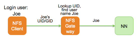

    User authentication and mapping:
    NFS gateway uses AUTH_UNIX-style authentication, which means that the the login user on the client is the same user that NFS passes to the HDFS. For example, if the NFS client has current user as admin, when the user accesses the mounted directory, NFS gateway will access HDFS as user admin. To access HDFS as hdfs user, you must first switch the current user to hdfs on the client system before accessing the mounted directory.
  2. Set up client machine users to interact with HDFS through NFS.
    The NFS gateway converts the User Identifier (UID) to username, and HDFS uses username to check permissions.
    The system administrator must ensure that the user on NFS client machine has the same name and UID as that on the NFS gateway machine. This is usually not a problem if you use the same user management system such as LDAP/NIS to create and deploy users to HDP nodes and to client node.
    If the user is created manually, you might need to modify the UID on either the client or NFS gateway host in order to make them the same:
    usermod -u 123 $myusername
    The following diagram illustrates how the UID and name are communicated between the NFS client, NFS gateway, and NameNode.
