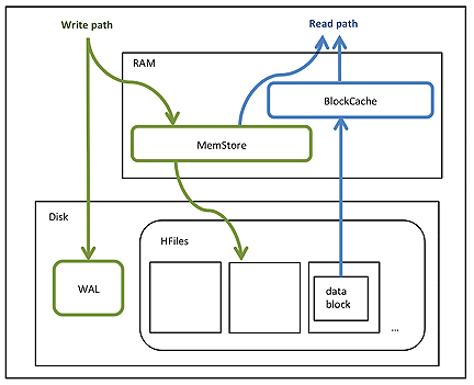

The following figure shows these simplified write and read paths:
  • During write operations, HBase writes to WAL and MemStore. Data is flushed from MemStore to disk according to size limits and flush interval.
  • During read operations, HBase reads the block from BlockCache or MemStore if it is available in those caches. Otherwise, it reads from disk and stores a copy in BlockCache.
Figure 5.1. HBase Read/Write Operations

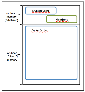

By default, BlockCache resides in an area of RAM that is managed by the Java Virtual Machine (JVM) garbage collector; this area of memory is known as on-heap memory or the JVM heap. The BlockCache implementation that manages the on-heap cache is called LruBlockCache.
If you have stringent read latency requirements and you have more than 20 GB of RAM available on your servers for use by HBase RegionServers, consider configuring BlockCache to use both on-heap and off-heap memory. BucketCache is the off-heap memory equivalent to LruBlockCache in on-heap memory. Read latencies for BucketCache tend to be less erratic than LruBlockCache for large cache loads because BucketCache (not JVM garbage collection) manages block cache allocation. The MemStore always resides in the on-heap memory.
Figure 5.2. Relationship among Different BlockCache Implementations and MemStore

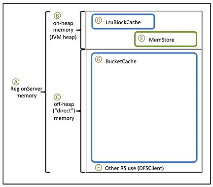

​Configuring Off-Heap Memory (BucketCache)
[Note]Note
Before configuring off-heap memory, complete the tasks in the previous "Configuring BlockCache" section.
To prepare for BucketCache configuration, compare the figure and table below before proceeding to the "Configuring BucketCache" steps.
Figure 5.3. Diagram of Configuring BucketCache
In the following table:
  • The first column refers to the elements in the figure.
  • The second column describes each element and, if applicable, its associated variable or property name.
  • The third column contains values and formulas.
  • The fourth column computes values based on the following sample configuration parameters:
    • 128 GB for the RegionServer process (there is additional memory available for other HDP processes)
    • A workload of 75% reads, 25% writes
    • HBASE_HEAPSIZE = 20 GB (20480 MB)
[Note]Note
Most of the following values are specified in megabytes; three are proportions.
Item
Description
Value or Formula
Example
A
Total physical memory for RegionServer operations: on-heap plus off-heap ("direct") memory (MB)
(hardware dependent)
131072
B
The HBASE_HEAPSIZE (-Xmx) property: Maximum size of JVM heap (MB)
This value was set when the BlockCache was configured.
Recommendation: 20480
20480
C
The -XX: MaxDirectMemorySize option: Amount of off-heap ("direct") memory to allocate to HBase (MB)
A - B
131072 - 20480 = 110592
Dp
The hfile.block.cache.size property: Proportion of maximum JVM heap size (HBASE_HEAPSIZE, -Xmx) to allocate to BlockCache. The sum of this value plus the hbase.regionserver. global.memstore.size must not exceed 0.8.
(proportion of reads) * 0.8
0.75 * 0.8 = 0.6
Dm
Maximum amount of JVM heap to allocate to BlockCache (MB)
B * Dp
20480 * 0.6 = 12288
Ep
The hbase.regionserver. global.memstore.size property: Proportion of maximum JVM heap size (HBASE_HEAPSIZE, -Xmx) to allocate to MemStore. The sum of this value plus hfile.block.cache.size must be less than or equal to 0.8.
0.8 - Dp
0.8 - 0.6 = 0.2
F
Amount of off-heap memory to reserve for other uses (DFSClient; MB)
Recommendation: 1024 to 2048
2048
G
Amount of off-heap memory to allocate to BucketCache (MB)
C - F
110592 - 2048 = 108544
The hbase.bucketcache.size property: Total amount of memory to allocate to BucketCache, on-heap and off-heap (MB)
G
108544
The hbase.bucketcache. percentage.in.combinedcache property: The proportion of memory allocated to BucketCache (off-heap cache), relative to all BlockCache (on- and off-heap)
G / (Dm + G)
108544 / 120832 = 0.89830508474576
​Configuring BucketCache
To configure BucketCache:
  1. In the hbase-env.sh file for each RegionServer, or in the hbase-env.sh file supplied to Ambari, set the -XX:MaxDirectMemorySize argument for HBASE_REGIONSERVER_OPTS to the amount of direct memory you want to allocate to HBase.
    In the sample configuration, the value would be 110592m (-XX:MaxDirectMemorySize accepts a number followed by a unit indicator; m indicates megabytes);
    HBASE_OPTS="$HBASE_OPTS -XX:MaxDirectMemorySize=110592m"
  2. In the hbase-site.xml file, specify BucketCache size and percentage.
    For the sample configuration, the values would be 120832 and 0.89830508474576, respectively. You can round up the proportion. This allocates space related to the rounding error to the (larger) off-heap memory area.
