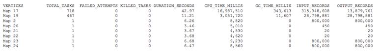

  2. Are you getting unusually high garbage collection times?
    1. Sometimes garbage collection inside the Java Virtual Machine can take up a substantial portion of the total execution time. Check garbage collection time against the CPU time by either enabling hive.tez.exec.print.summary, or by checking the Tez UI:
      Figure 5.1. Garbage Collection Time
    2. If you see high garbage collection times, identify the operator that is causing it. Based on the operator that is causing the high garbage collection times, you can take the following actions:
