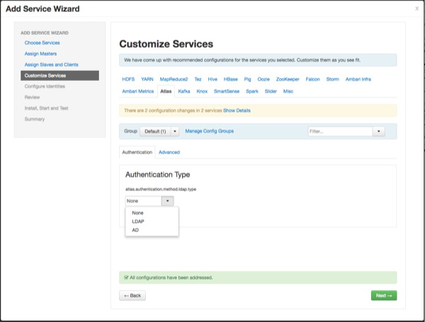

​Authentication Settings
You can set the Authentication Type to None, LDAP, or AD. If authentication is set to None, file-based authentication is used.
​File-based Authentication
Select None to default to file-based authentication.

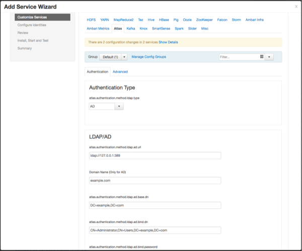

​LDAP Authentication
To enable LDAP authentication, select LDAP, then set the following configuration properties.
Table 2.2. Apache Atlas LDAP Configuration Settings
PropertySample Values
atlas.authentication.method.ldap.urlldap://127.0.0.1:389
atlas.authentication.method.ldap.userDNpatternuid={0],ou=users,dc=example,dc=com
atlas.authentication.method.ldap.groupSearchBasedc=example,dc=com
atlas.authentication.method.ldap.groupSearchFilter(member=cn={0},ou=users,dc=example,dc=com
atlas.authentication.method.ldap.groupRoleAttribute cn
atlas.authentication.method.ldap.base.dndc=example,dc=com
atlas.authentication.method.ldap.bind.dncn=Manager,dc=example,dc=com
atlas.authentication.method.ldap.bind.passwordPassW0rd
atlas.authentication.method.ldap.referralignore
atlas.authentication.method.ldap.user.searchfilter(uid={0})
atlas.authentication.method.ldap.default.roleROLE_USER
​AD Authentication
To enable AD authentication, select AD, then set the following configuration properties.
Table 2.3. Apache Atlas AD Configuration Settings
atlas.authentication.method.ldap.ad.urlldap://127.0.0.1:389
Domain Name (Only for AD)example.com
atlas.authentication.method.ldap.ad.base.dnDC=example,DC=com
atlas.authentication.method.ldap.ad.bind.dnCN=Administrator,CN=Users,DC=example,DC=com
atlas.authentication.method.ldap.ad.bind.passwordPassW0rd
atlas.authentication.method.ldap.ad.referralignore
atlas.authentication.method.ldap.ad.user.searchfilter(sAMAccountName={0})
atlas.authentication.method.ldap.ad.default.roleROLE_USER

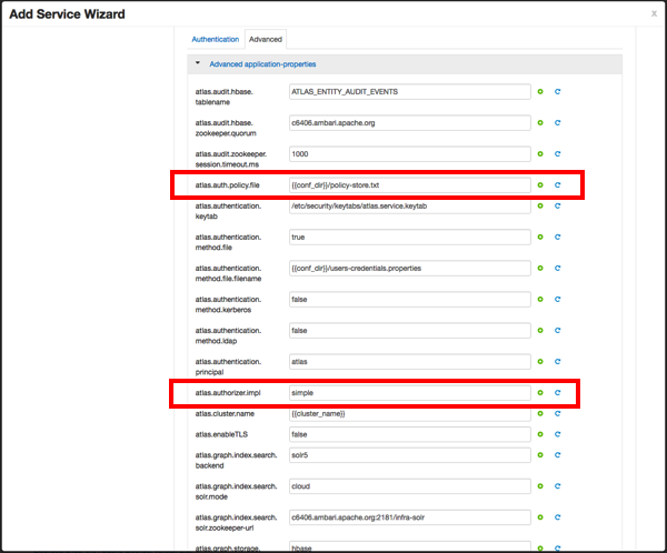

​Simple Authorization
The default setting is Simple, and the following properties are automatically set under Advanced application-properties on the Advanced tab.
Table 2.4. Apache Atlas Simple Authorization
PropertyValue
atlas.authorizer.implsimple
atlas.auth.policy.file{{conf_dir}}/policy-store.txt
The policy-store.txt file has the following format:
Policy_Name;;User_Name:Operations_Allowed;;Group_Name:Operations_Allowed;;Resource_Type:Resource_Name
For example:
adminPolicy;;admin:rwud;;ROLE_ADMIN:rwud;;type:*,entity:*,operation:*,taxonomy:*,term:*
userReadPolicy;;readUser1:r,readUser2:r;;DATA_SCIENTIST:r;;type:*,entity:*,operation:*,taxonomy:*,term:*
userWritePolicy;;writeUser1:rwu,writeUser2:rwu;;BUSINESS_GROUP:rwu,DATA_STEWARD:rwud;;type:*,entity:*,operation:*,taxonomy:*,term:*
In this example readUser1, readUser2, writeUser1 and writeUser2 are the user IDs, each with its corresponding access rights. The User_Name, Group_Name and Operations_Allowed are comma-separated lists.

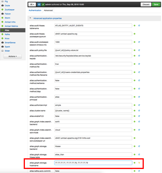

​Using Distributed HBase as the Atlas Metastore
Apache HBase can be configured to run in stand-alone and distributed mode. The Atlas Ambari installer uses the stand-alone Ambari HBase instance as the Atlas Metastore by default. The default stand-alone HBase configuration should work well for POC (Proof of Concept) deployments, but you should consider using distributed HBase as the Atlas Metastore for production deployments. Distributed HBase also requires a ZooKeeper quorum.
Use the following steps to configure Atlas for distributed HBase.
[Note]Note
This procedure does not represent a migration of the Graph Database, so any existing lineage reports will be lost.
  1. On the Ambari dashboard, select Atlas > Configs > Advanced, then select Advanced application-properties.
  2. Set the value of the atlas.graph.storage.hostname property to the value of the distributed HBase ZooKeeper quorum. This value is a comma-separated list of the servers in the distributed HBase ZooKeeper quorum:
    host1.mydomain.com,host2.mydomain.com,host3.mydomain.com
  3. Click Save to save your changes, then restart Atlas and all other services that require a restart. As noted previously, Oozie requires a restart after an Atlas configuration change (even if it is not marked as requiring a restart).

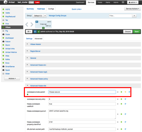

  4. If HBase is running in secure mode, select HBase > Configs > Advanced on the Ambari dashboard, then select Advanced hbase-site. Set the value of the zookeeper.znode.parent property to /hbase-secure (if HBase is not running in secure mode, you can leave this property set to the default /hbase-unsecure value).
  5. Click Save to save your changes, then restart HBase and all other services that require a restart.
