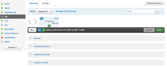

  1. In Ambari, open Services > Tez > Configs tab.
  2. Use the following table as a reference checklist. Some
    [Tip]Tip
    Ambari automatically customizes the value for the tez.am.resource.memory.mb property to suit your cluster profile. Generally, you should not change the default value of this property at this stage if you are not changing resources on the cluster.
  3. You can view the properties by either of these methods:
    Type each property name in the Filter field in the top right corner.
    Open the General, Advanced tez-env, etc., sections and scan the lists of each category.
  4. Click Save.
  5. If prompted to restart, restart the Tez Service.
