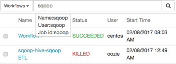

    1. Type a term in the Filter field.
      As you type, the filter displays a popup showing possible name:value pairs.
    2. Click one of the name:value pairs listed in the popup.
      The table displays items that match the search filter term.

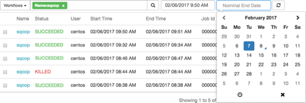

    3. Click the Nominal Start Date or Nominal End Date field and type, or select from the popup calendar, a date and time.
      Use the format mm/dd/yyyy hh:mm AM/PM, such as 02/07/2017 4:33 PM.
