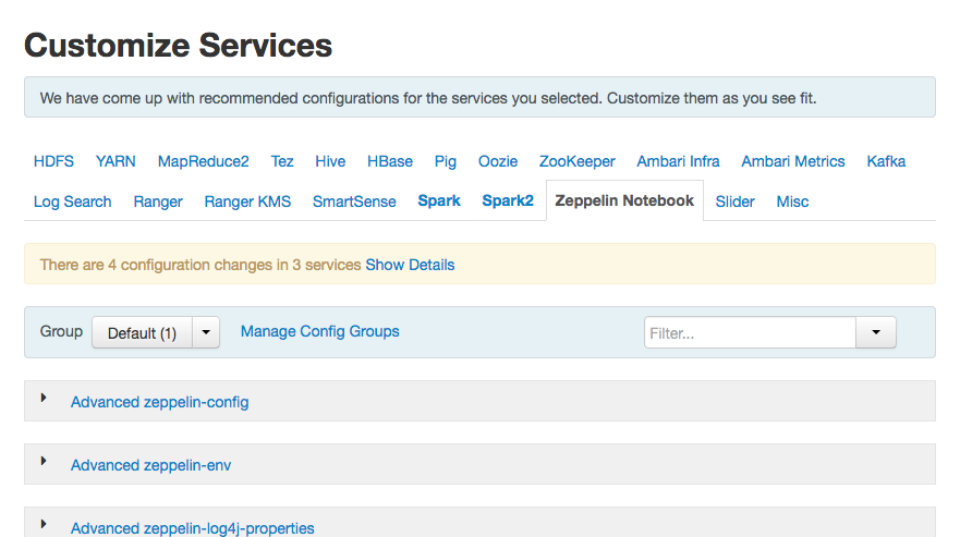

  6. On the Customize Services page, review default values and click "Next" to continue.

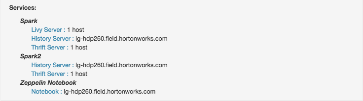

  8. On the Review page, scroll down to the "Services" section and confirm the node selected to run the Zeppelin service; for example:

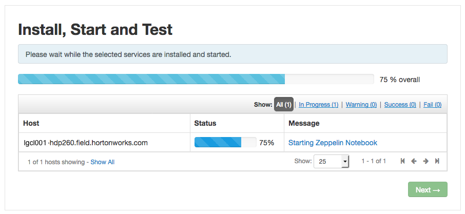

  9. Click "Deploy" to complete the installation process. The Install, Start and Test page shows status as deployment proceeds:
