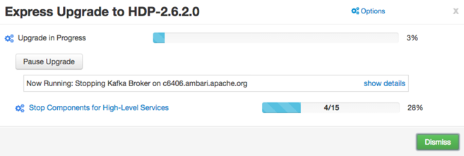

  2. When the prerequisite checks complete, the upgrade starts. The time required to perform the upgrade depends on many factors. As part of the upgrade process, each component in the cluster restarts in a serial fashion. The stop/start times contribute to the total upgrade time.
  3. The upgrade process includes the following stages. Some stages require that you complete an action during normal operation.
    If any stage fails, the upgrade stops and prompts you for action.
