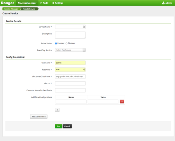

Use the following steps to add a service to Hive:
  1. On the Service Manager page, click the Add icon () next to Hive.
    The Create Service page appears.
  2. Enter the following information on the Create Service page:
    Table 3.28. Service Details
    Field name
    Description
    Service Name
    The name of the service; required when configuring agents.
    Description
    A description of the service.
    Active Status
    Enabled or Disabled.
    Select Tag ServiceSelect a tag-based service to apply the service and its tag-based policies to Hive.
    Table 3.29. Config Properties
    Field name
    Description
    Username
    The end system username that can be used for connection.
    Password
    The password for the username entered above.
    jdbc.driver ClassName
    The full classname of the driver used for Hive connections. Default: org.apache.hive.jdbc.HiveDriver
    jdbc.url
    The complete connection URL, including port and database name. (Default port: 10000.) For example, on the sandbox, jdbc:hive2://sandbox:10000/.
    Common Name For Certificate
    The name of the certificate.
    This field is interchangeably named Common Name For Certificate and Ranger Plugin SSL CName in Create Service pages.
    Add New Configurations
    Add any other new configuration(s).
  3. Click Test Connection.
  4. Click Add.

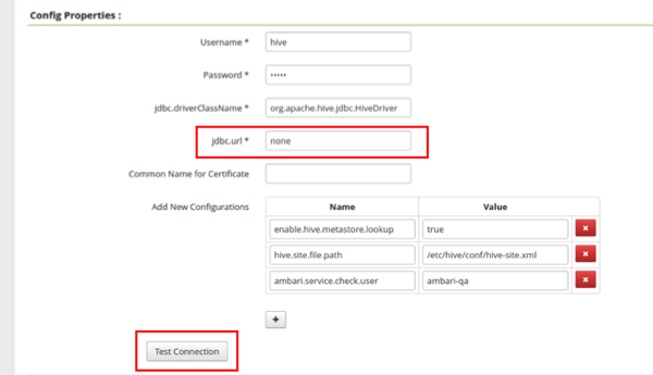

Usually, the Ranger Hive service definition uses the HiveServer2 (HS2) JDBC driver to fetch Hive database/table info for resource lookup and testing the connection. Alternatively, you can configure the service definition to use Hive metastore libraries connecting to the Hive metastore database directly. This is recommended when it is difficult to set up HiveServer2 on your cluster, such as when using HDCloud for AWS.

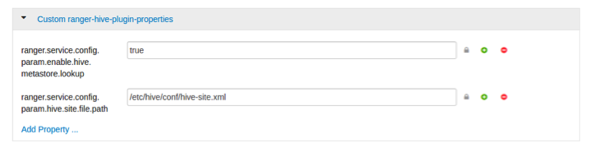

  1. Under Ambari>Hive>Configs>Advanced, edit Hive properties:
  2. Add the below properties to custom ranger-hive-plugin-properties:
    ranger.service.config.param.enable.hive.metastore.lookup = true
    ranger.service.config.param.hive.site.file.path = /etc/hive/conf/hive-site.xml
  3. Save and restart required components.
To test the configuration is successful, create a new Hive service and specify the jdbc.url as "none", then run Test Connection.
