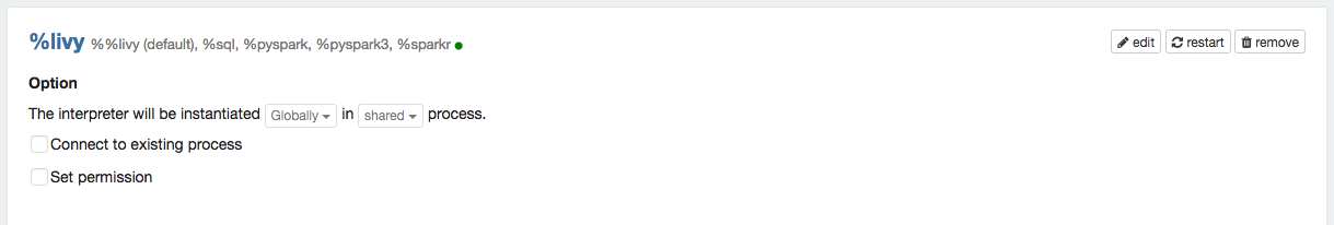

  • Before using Livy in a note, check the Interpreter page to ensure that the Livy interpreter is configured properly for your cluster:
Note: The Interpreter page is subject to access control settings. If the Interpreters page does not list access settings, check with your system administrator for more information.
