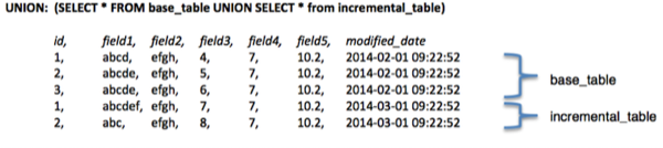

  2. Reconcile or merge the data.
    Create a view that uses UNION ALL to merge the data and reconcile the base table records with the new records:
    CREATE VIEW reconcile_view AS
    SELECT t1.* FROM
        (SELECT * FROM base_table
         UNION ALL
         SELECT * from incremental_table) t1
    JOIN
        (SELECT id, max(modified_date) max_modified FROM
             UNION ALL
         GROUP BY id) t2
    ON t1.id = t2.id AND t1.modified_date = t2.max_modified;
    EXAMPLES:
      Figure 2.4. Dataset after the UNION ALL Command Is Run
      Figure 2.5. Dataset in the View
      [Note]Note
      In the reconcile_view only one record exists per primary key, which is shown in the id column. The values displayed in the id column correspond to the latest modification date that is displayed in the modified_date column.
