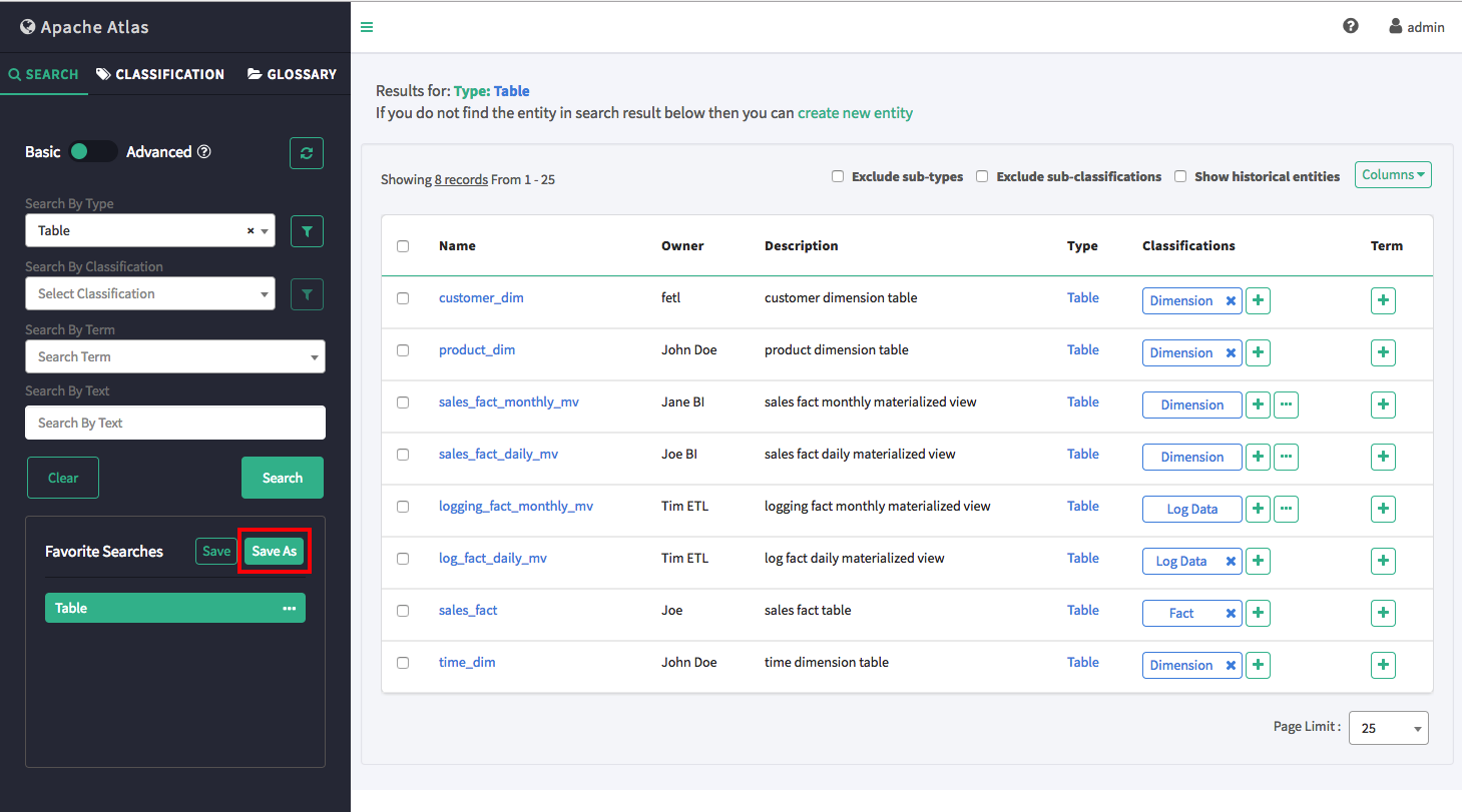

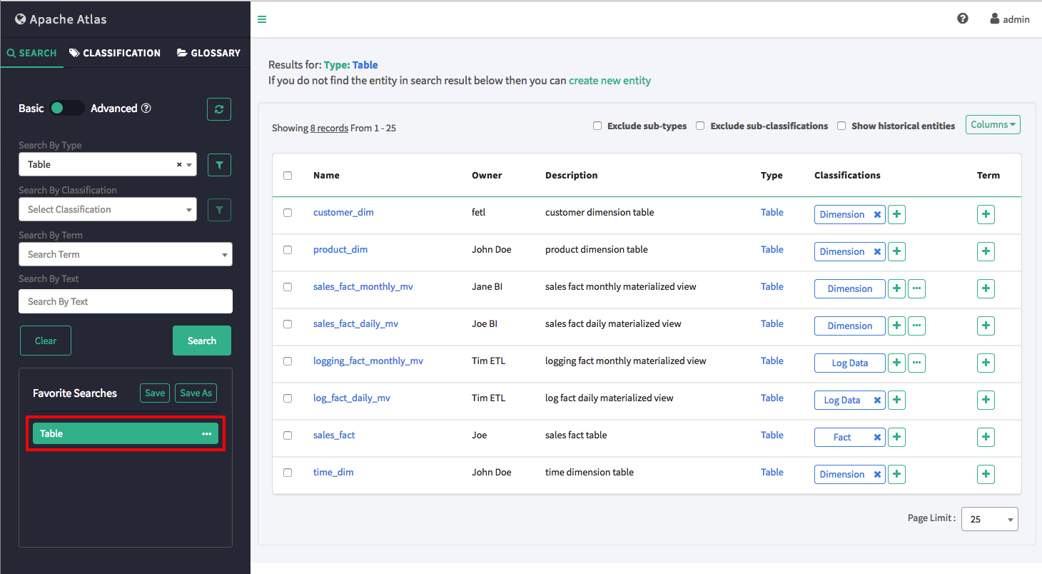

You can use the Favorite Searches box to save both Basic and Advanced Atlas searches.

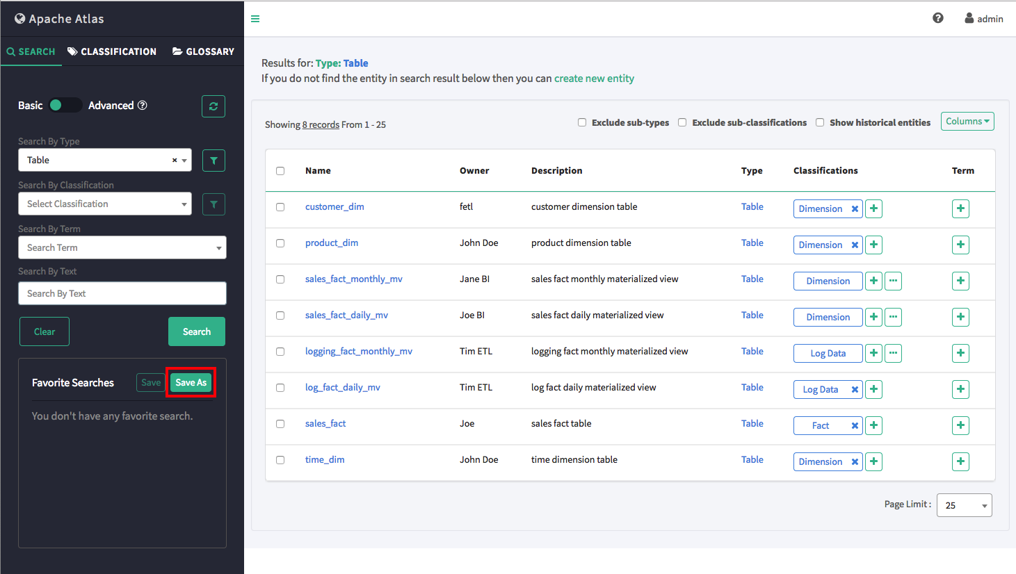

  1. To demonstrate saved searches, let's start with a Basic search for the Table entity type.
  2. To save this search, click Save As under Favorite Searches.

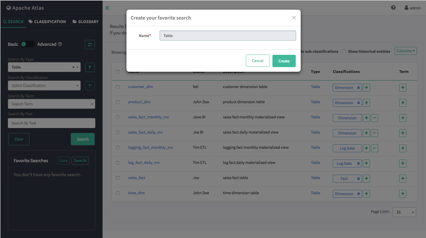

  3. On the Create Your Favorite Search pop-up, type a name for the search in the Name box, then click Create. In this example, the search name is "Table".
  4. The saved search appears in the Favorite Searches box.

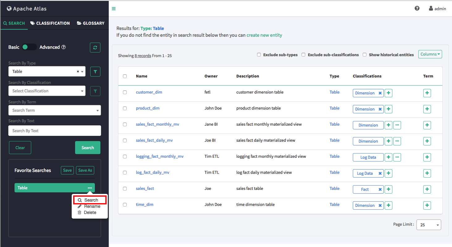

  5. To run a saved search:
    • Click the search name in the Favorite Searches list, then click Search.
      -or-
    • Click the ellipsis symbol (…) for the saved search, then click Search in the drop-down menu.
    Note
    Note
    You can also use the ellipsis symbol drop-down menu to rename or delete a saved search.

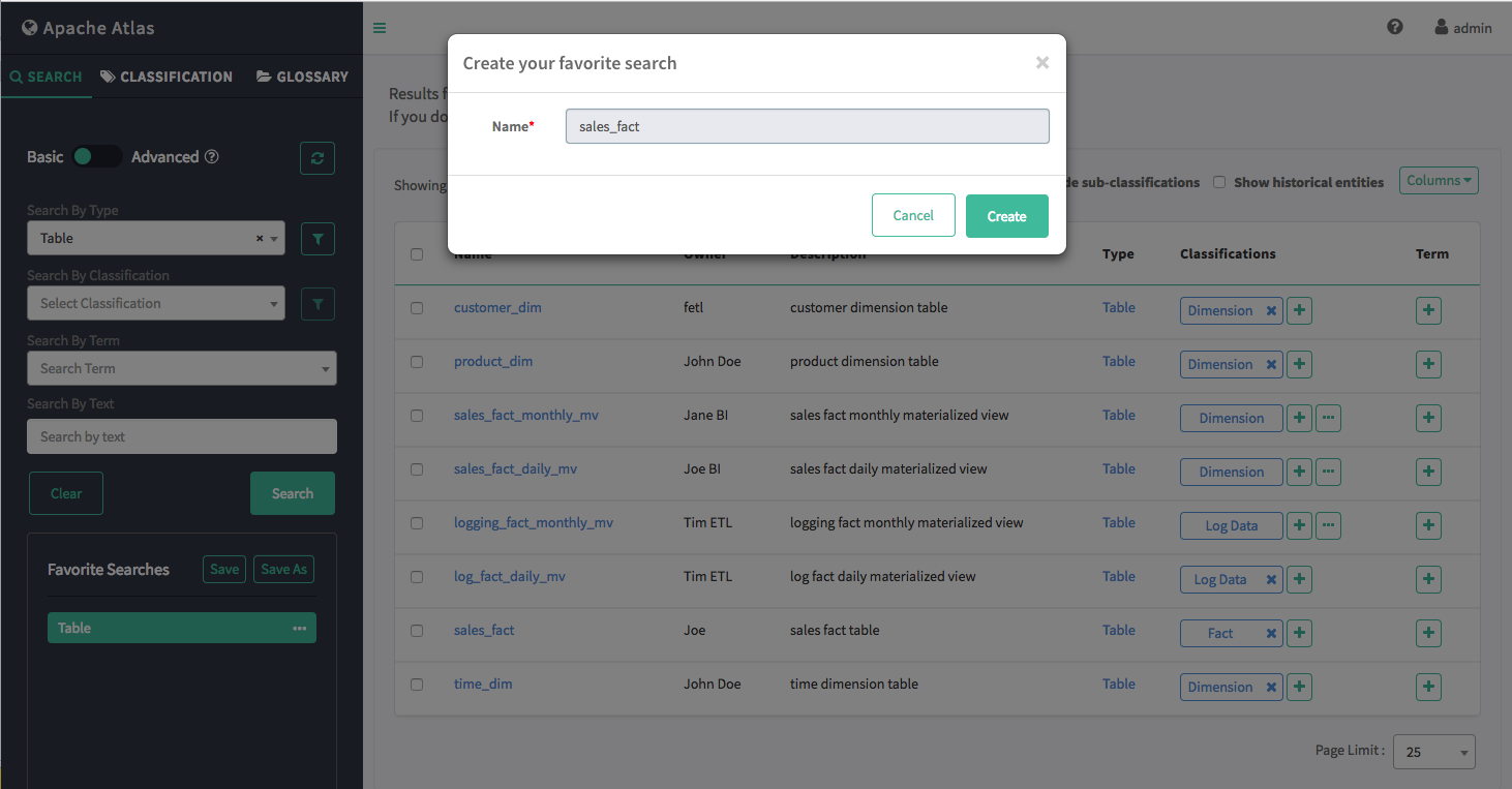

  6. Now let's save this search under a new name, then change the search criteria and save the new search. To save a search under a new name, click the search, then click Save As.
  7. On the "Create your favorite search" pop-up, type a name for the new search in the Name box, then click Create. In this example, the new search name is "sales_fact".

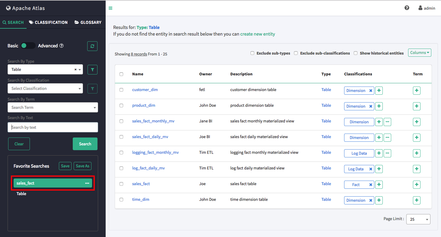

  8. The new search appears in the Favorite Searches box.
  9. Next we add a full-text search string to find Table entities whose name contains the text string "sales_fact", then click Search to update the search results. To save this new set of search criteria to the "sales_fact" search, click Save under Favorite Searches.
