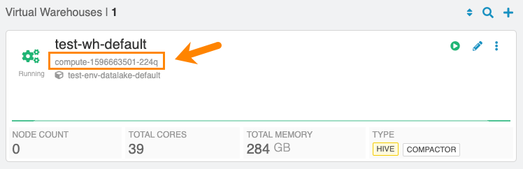

- Get the CDW namespace for your Virtual Warehouse:
- From the Management Console home page left menu, click Data Warehouse in the left menu. You are taken to the Overview page of CDW Private Cloud service.
- Locate the Virtual Warehouse you want to configure log storage for in the
right-most column of the page, and locate the CDW namespace, which starts with
compute-as shown below:
