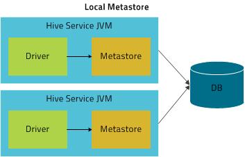

Local Mode
In this mode the Hive metastore service runs in the same process as the main HiveServer process, but the metastore database runs in a separate process, and can be on a separate host. The embedded metastore service communicates with the metastore database over JDBC.

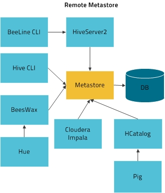

Remote Mode
Cloudera recommends that you use this mode.
In this mode the Hive metastore service runs in its own JVM process; HiveServer2, HCatalog, Cloudera Impala™, and other processes communicate with it via the Thrift network API (configured via the hive.metastore.uris property). The metastore service communicates with the metastore database over JDBC (configured via the javax.jdo.option.ConnectionURL property). The database, the HiveServer process, and the metastore service can all be on the same host, but running the HiveServer process on a separate host provides better availability and scalability.
The main advantage of Remote mode over Local mode is that Remote mode does not require the administrator to share JDBC login information for the metastore database with each Hive user. HCatalogrequires this mode.
