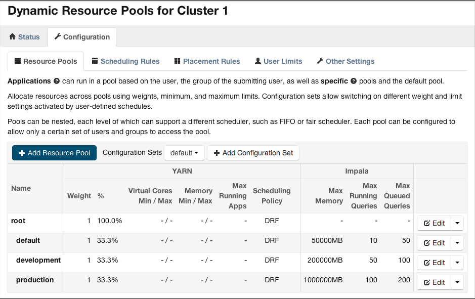

The following figure shows a sample of the Dynamic Resource Pools page in Cloudera Manager, accessed through the menu choice. Numbers from all the resource pools are combined into the topmost root pool. The default pool is for users who are not assigned any other pool by the user-to-pool mapping settings. The development and production pools show how you can set different limits for different classes of users, for total memory, number of concurrent queries, and number of queries that can be queued.

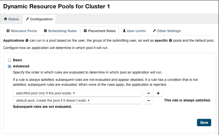

The following figure shows a sample of the Placement Rules page in Cloudera Manager, accessed through the menu choice. The settings demonstrate a reasonable configuration of a pool named default to service all requests where the specified resource pool does not exist, is not explicitly set, or the user or group is not authorized for the specified pool.
