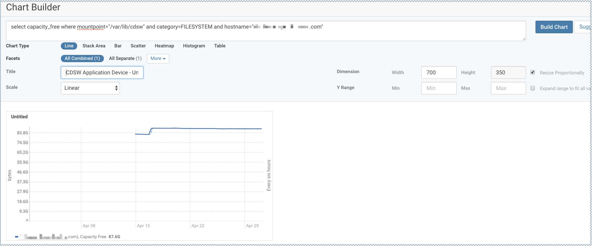

Create a Chart to Track Disk Usage on the Application Block Device
- Log into the Cloudera Manager Admin Console.
- Click .
- Enter a tsquery that charts memory
usage on the block device. For example, the following tsquery creates a chart to track unallocated memory on the Application block device.
select capacity_free where mountpoint="/var/lib/cdsw" and category=FILESYSTEM and hostname="<CDSW_Master_hostname>"
Alternatively, you could use the following tsquery to track the amount of memory already in use on the block device.Make sure you insert the hostname for your master node as indicated in the queries.select capacity, capacity_used where mountpoint="/var/lib/cdsw" and category=FILESYSTEM and hostname="<CDSW_Master_hostname>"
Click Build Chart. You should see a preview of the chart below.
- Click Save.
- Enter a name for the chart.
- Select Add chart to another dashboard. From the dropdown list of available System Dashboards, select CDH Cloudera Data Science Workbench Status Page.
Click Save Chart. If you navigate back to the CDSW service page, you should now see the new chart on this page.
For more details about Cloudera Manager's Chart Builder, see the following topic in the Cloudera Manager documentation: Charting Time Series Data .

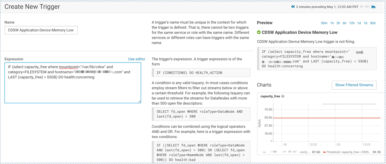

Create a Trigger to Notify Cluster Administrators when Free Space Runs Low
- Log in to Cloudera Manager and go to the CDSW service page.
- Click Create Trigger.
- Give the trigger a name.
Modify the Expression field to include a condition for the trigger to fire. For example, if the trigger should fire when unallocated memory on the Application Block Device falls below 250GB, the expression should be:
IF (select capacity_free where mountpoint="/var/lib/cdsw" and category=FILESYSTEM and hostname="<CDSW_Master_hostname>" and LAST (capacity_free) < 250GB) DO health:concerning
On the right hand side of the page, you should see a preview of the query you have entered and a chart that displays the result of the query as in the following sample image. Note that if the query is incorrect or incomplete you will not see the preview on the right.
Click Create Trigger. If you navigate back to the CDSW service page, you should now see the new trigger in the list of Health Tests.
