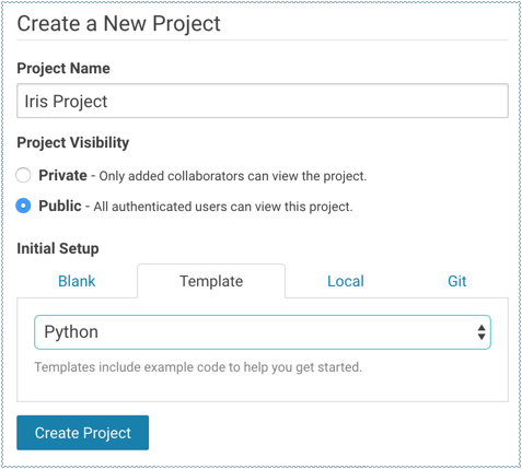

Create a Project
The scripts for this example are available in the Python template project that ships with Cloudera Data Science Workbench. First, create a new project from the Python template:

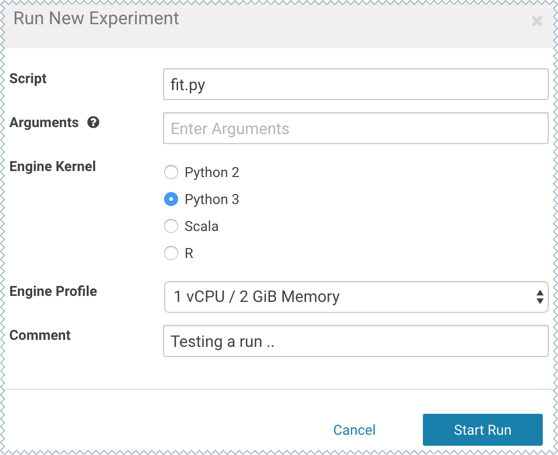

Click Run Experiment.
Fill out the form as follows and click Start Run. Make sure you use the Python 3 kernel.

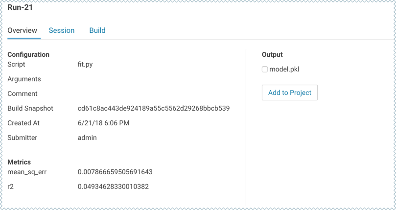

The new experiment should now show up on the Experiments table. Click on the Run ID to go to the experiment's Overview page. The Build and Session tabs display realtime progress as the experiment builds and executes.
Once the experiment has completed successfully, go back to its Overview page. The tracked metrics show us that our test set had an MSE of ~0.0078 and an R2 of ~0.0493. For the purpose of this demo, let's consider this an accurate enough model to deploy and use for predictions.
Once you have finished training and comparing metrics from different experiments, go to the experiment that generated the best model. From the experiment's Overview page, select the model.pkl file and click Add to Project.

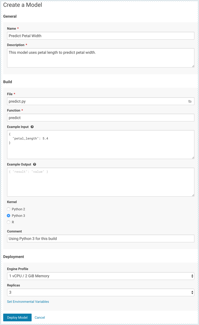

Click New Model and fill out the fields. Make sure you use the Python 3 kernel. For example:
- Deploy the model.

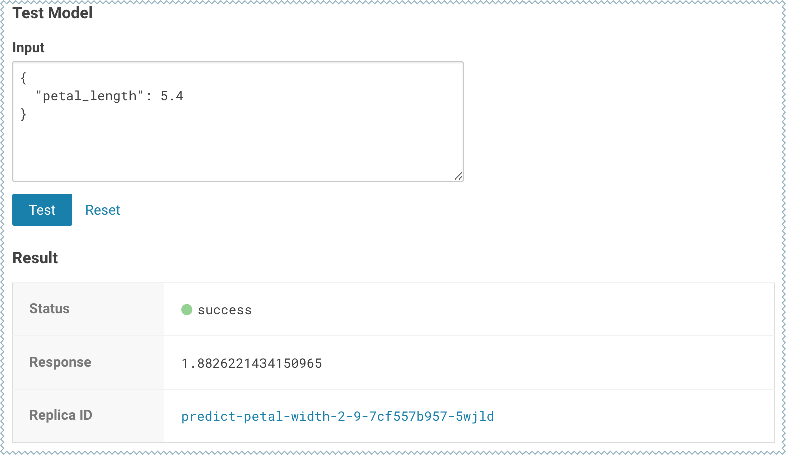

To test the model, use the Test Model widget on the model's Overview page.
