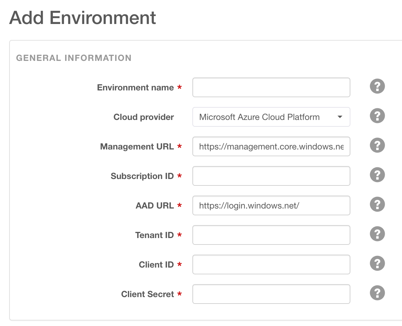

- In the Add Environment screen:
- Enter a name in the Environment Name field.
- In the Cloud provider field, select Azure Cloud Platform.
- In the Management URL field, enter the Azure management URL provided by Microsoft. You don’t need to change the default value unless you are in an Azure region that uses a different URL.
- In the Subscription ID field, enter the Azure subscription ID.
- In the AAD URL field, enter the Azure Active Directory (AAD) URL provided by Microsoft. You don’t need to change the default value unless you are in an Azure region that uses a different URL.
- In the Tenant ID field, enter the AAD tenant ID of your ADD tenant. See Obtain Obtaining Credentials for Cloudera Director for details on obtaining the AAD tenant ID.
- In the Client ID field, enter the client ID of the Azure service principal you created earlier. See Obtaining Credentials for Cloudera Director for details on obtaining the client ID.
- In the Client Secret field, enter the client secret of the Azure service principal you created earlier. See Obtaining Credentials for Cloudera Director for details on obtaining the client secret.

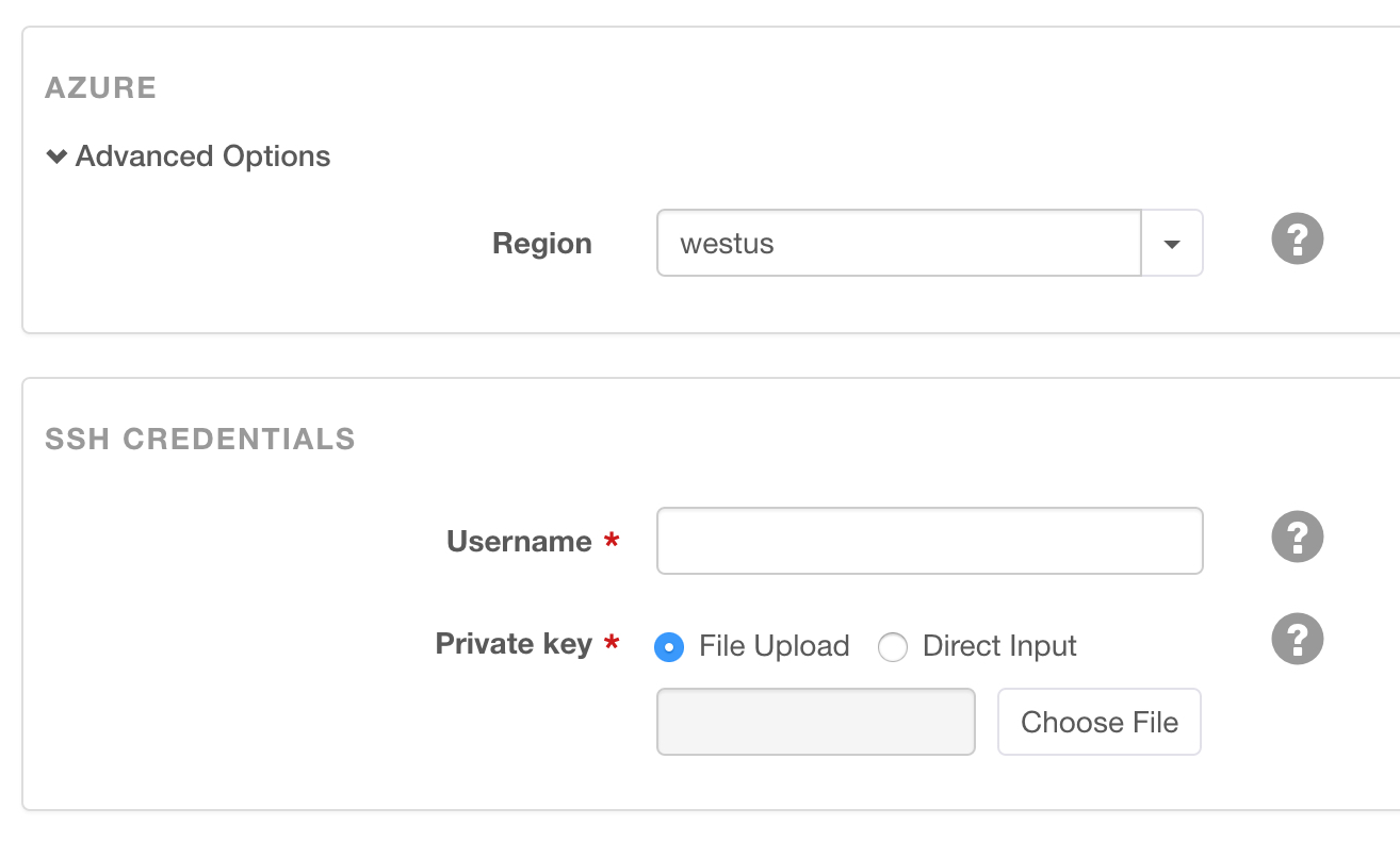

- In the Advanced Options area, select the Azure region where your cluster is located from the drop down list.
- In the Advanced Options section, enter the Azure region where your Cloudera Director instance is located.
- In the SSH Credentials section:
- Enter a username in the Username field. Azure will create the user specified here.
- Create an SSH key with the following command:
ssh-keygen -f ~/.ssh/my_azure_vm_keyname -t rsa
- Copy the SSH private key into the Private key field. Cloudera Director uses the SSH key pairs to create and access VMs in Azure.
- Click Continue to add Cloudera Manager.

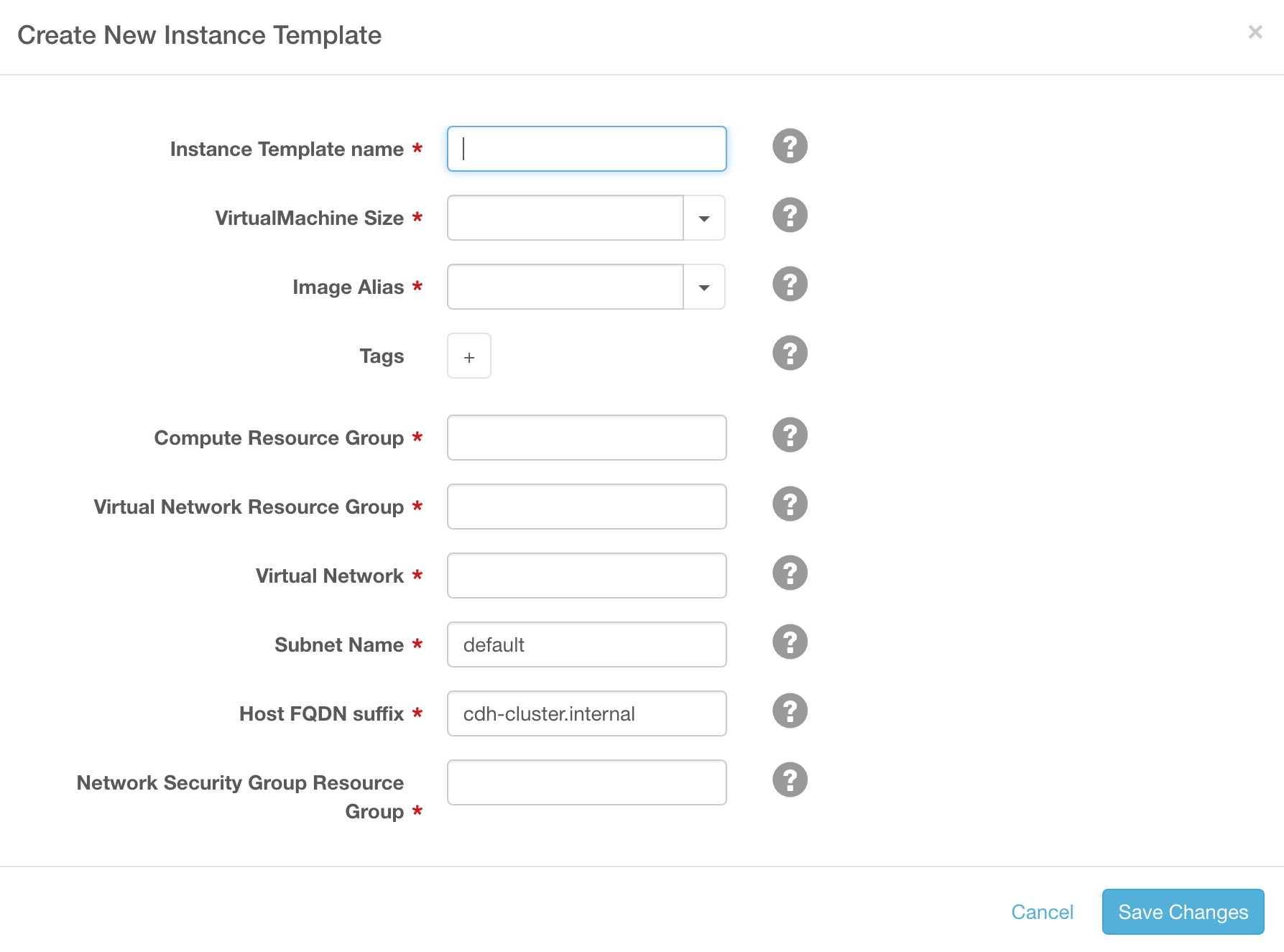

- In the Instance Template field, select Create New Instance Template.
- The Instance Template model screen displays.
- In the Instance Template model screen, do the following:
- In the Instance Template name field, enter a name for the template.
- In the Instance Type field, select STANDARD_DS13 or STANDARD_DS14.
- In the Image Alias field, select cloudera-centos-6-latest.
- In the Tags field, add one or more tags to associate with the instance.
- In the Compute Resource Group field, enter the name of the resource group you created earlier to house the VM.
- In the Virtual Network Resource Group field, enter the name where the virtual network resource resides.
- In the Virtual Network field, enter the name of the virtual network.
- In the Subnet Name field, enter the name of the subnet you wish to use.
- In the Host FQDN suffix field, enter the name of the host FQDN suffix you would like your cluster host to use. This is the DNS domain of your cluster hosts.
- In the Network Security Group Resource Group field, enter the name of the resource group where the network security group resource resides.
- In the Network Security Group field, enter the name of the network security group.
- Select Yes in the Public IP field if you want to assign a public IP address to the VM. The default value is No.
- In the Availability Set field, enter the name of the availability set you created in earlier steps.

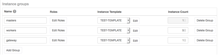

- In the Instance groups area, create a new template for the groups or for each group and the number of instances you want.
- Click Continue.

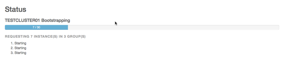

- At the confirmation prompt, click OK to deploy the cluster. Cloudera Director displays a status screen.
- When the cluster is ready, click Continue.
