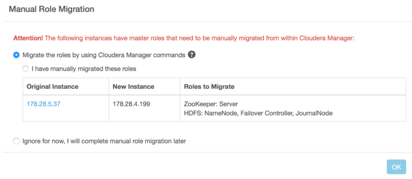

- If you have completed Step 1 (on Cloudera Director) and intend to complete Step 2 (on Cloudera Manager) at a later time, you can confirm which IP address to migrate from or to by going
to the cluster status page in Cloudera Director and clicking either the link for migration in the upper left, or the Modify Cluster button on the right. A popup
displays the hosts to migrate from and to:

- Click Details. The message "Attention: Cluster requires manual role migration" is displayed. Click More Details.
- Check the box labeled, "I have manually migrated these roles."
- Click OK.
