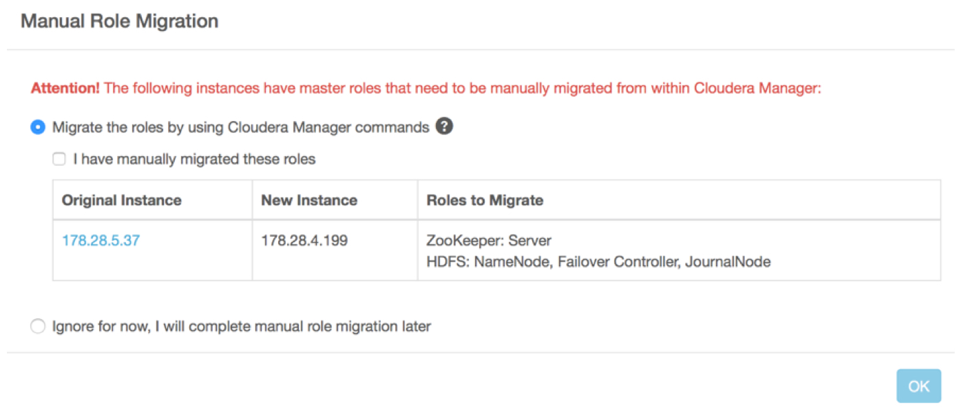

If you have completed Step 1 (on Cloudera Director) and intend to complete Step 2 (on Cloudera Manager) at a later time, you can confirm which IP address to migrate from or to by going
to the cluster status page in Cloudera Director and clicking either the link for migration in the upper left, or the Modify Cluster button on the right. A pop-up
displays the hosts to migrate from and to:
You do not need to check the boxes to restart and deploy client configuration at the start of the repair process. You restart and deploy the client configuration manually after role migration is complete.

In Cloudera Manager, open the cluster. On the Hosts tab, you see a new instance with no roles. The cluster is in an intermediate state, containing the new host to which the roles will be migrated and the old host from which the roles will be migrated.
Use the Cloudera Manager Migrate Roles wizard to move the roles.
See Moving Highly Available NameNode, Failover Controller, and JournalNode Roles Using the Migrate Roles Wizard in the Cloudera Administration guide.
Step 3: Delete the old instance in Cloudera Director
- In Cloudera Director, return to the cluster.
- Click Details. The message "Attention: Cluster requires manual role migration" is displayed. Click More Details.
- Check the box labeled, "I have manually migrated these roles."
- Click OK.
The failed instance is deleted from the cluster.
