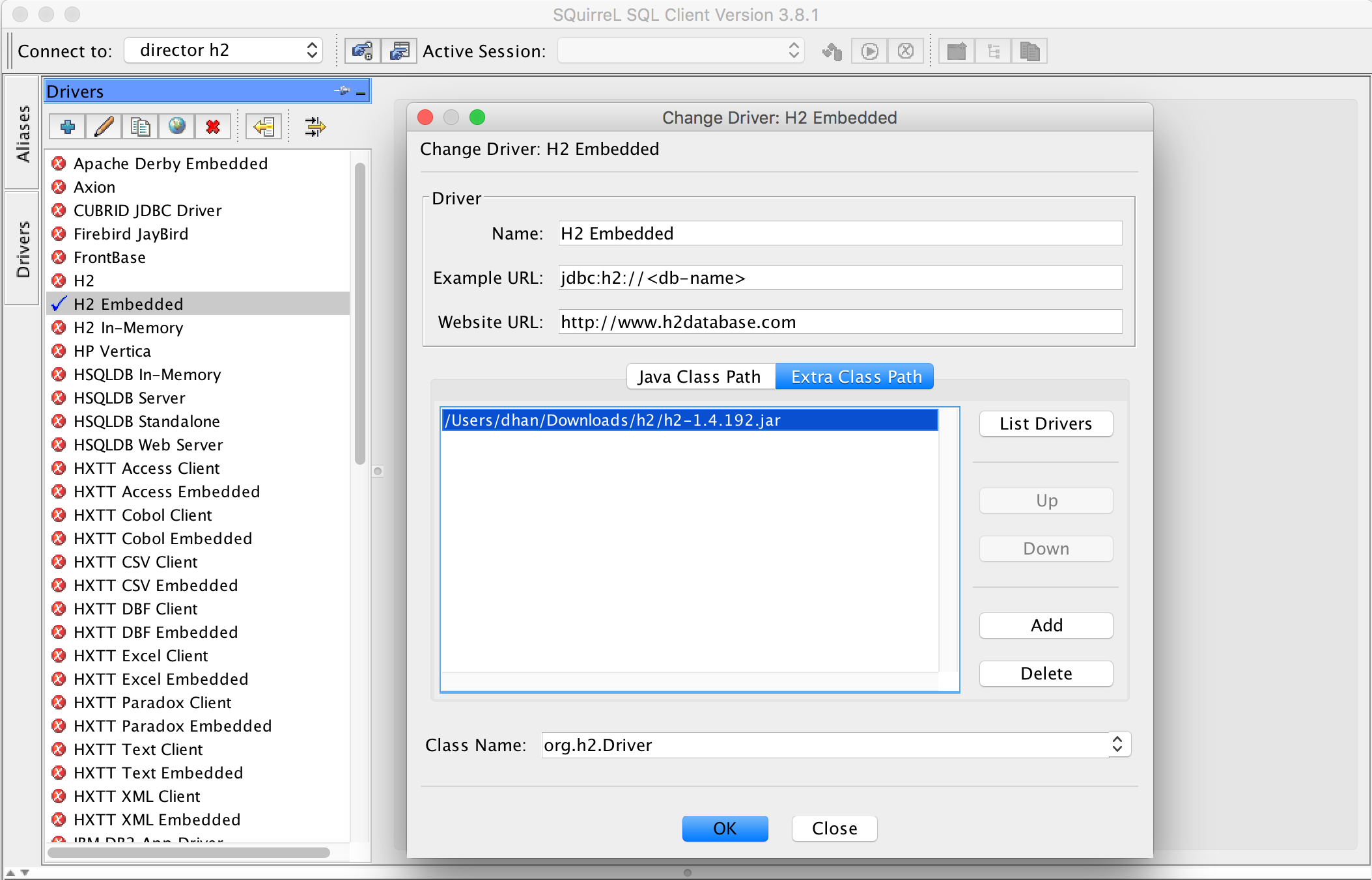

- Enable the H2 Embedded driver in SQuirreL SQL.
- Download H2 from http://www.h2database.com/html/download.html.
- Edit the H2 Embedded driver, adding the downloaded jar file to the Extra Class Path.
