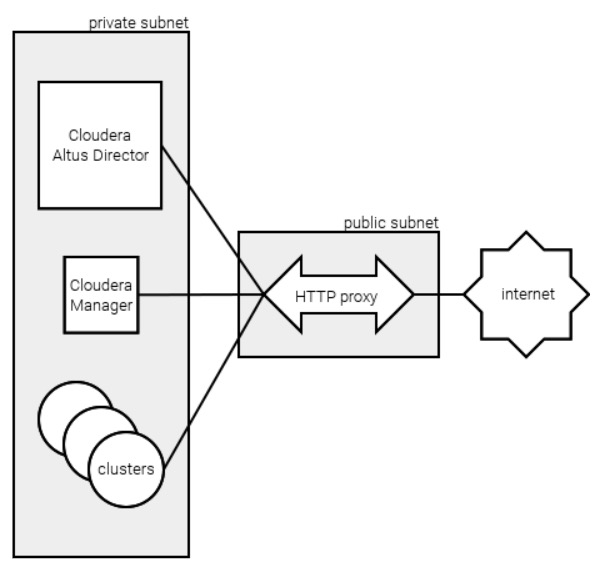

The diagram below shows one possible architecture where proxy use is necessary for Altus Director, Cloudera Manager, and clusters to reach the internet. In this case, all of the components run in a private subnet without internet access, but with the ability to reach a single proxy running in a separate, accessible public subnet.
