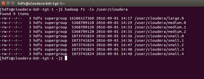

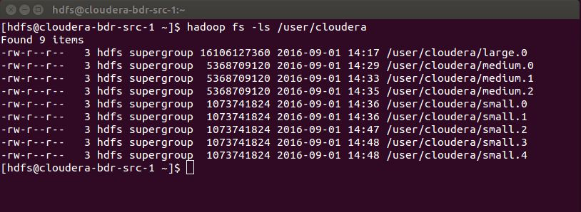

The example production cluster contains nine HDFS files in the /user/cloudera path:

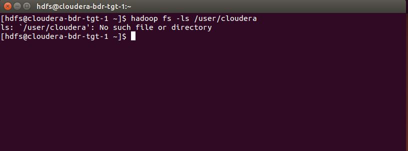

The example backup cluster has not been used as the destination of a replication schedule yet, so the HDFS file system has no /user/cloudera directory:

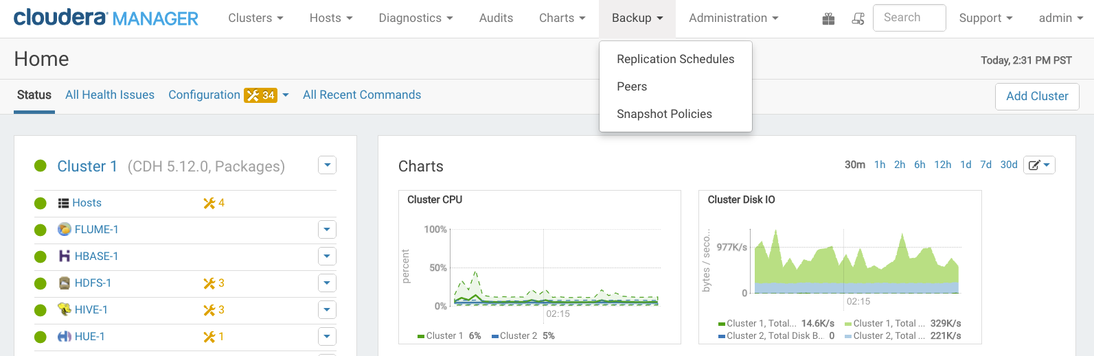

- Log in to Cloudera Manager Admin Console on the backup cluster.

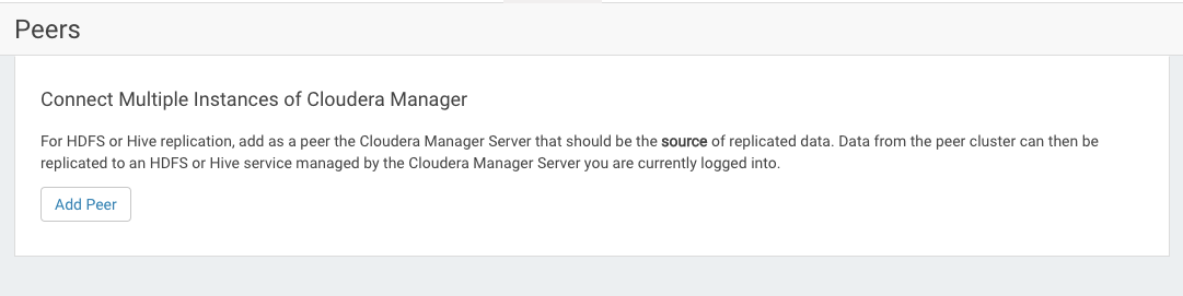

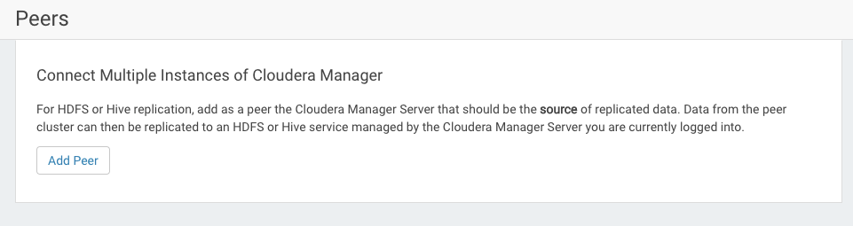

- Click the Backup tab and select Peers from the menu.
- On the Peers page, click Add Peer:

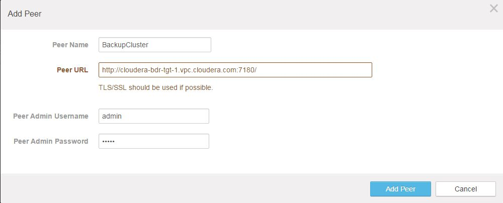

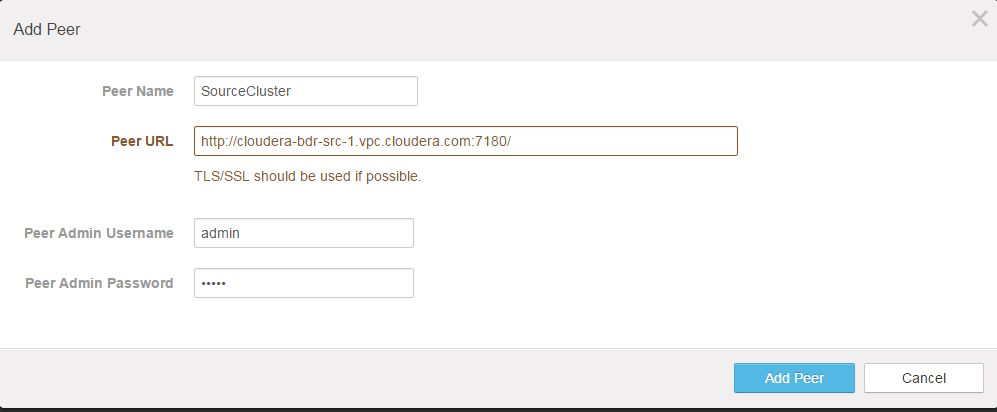

- On the Add Peer page:
- Peer Name - Enter a meaningful name for the cluster that you want to back up. This peer name becomes available in the next step, to be selected as the source for the replication.
- Peer URL - Enter the URL for the Cloudera Manager Admin Console running on the master node of the cluster.
- Peer Admin Username - Enter the administrator user account for the production cluster.
- Peer Admin Password - Enter the password for the administrator account for the production cluster.

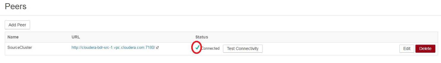

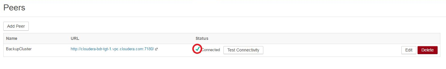

- Click Add Peer to save your settings, connect to the production cluster, and establish this peer relationship.
After the system establishes and verifies the connection to the peer, the Peers page re-displays, showing the Status column as Connected (note the green check-mark):

- Click the Backup tab and select Replication Schedules from the menu.
- On the Replication Schedules page, select .

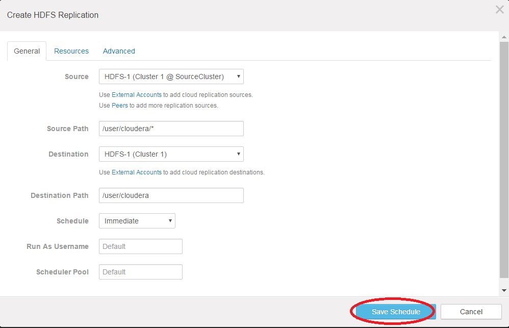

- On the Create HDFS Replication page, click the General tab to display the default schedule options:
- Source - Make sure the cluster node selected in the drop-down is the production cluster (the cluster to be backed up).
- Source Path - Specify the directory name on the production cluster holding the files to back up. Use an asterisk (*) on the directory name to specify that only the explicit directory and no others should be created on the destination. Without the asterisk, directories may be nested inside a containing directory on the destination.
- Destination - Select the cluster to use as the target of the replication process, typically, the cluster to which you have logged in and the cluster to which you want to backup HDFS data.
- Destination Path - Specify a directory name on the backup cluster.
- Schedule - Immediate.
- Run As Username - Leave as Default.
- Scheduler Pool - Leave as Default.
- Click Save Schedule.
The files are replicated from the source cluster to the backup cluster immediately.
When the process completes, the Replication Schedules page re-displays, showing a green check-mark and time-stamp in the Last Run column.

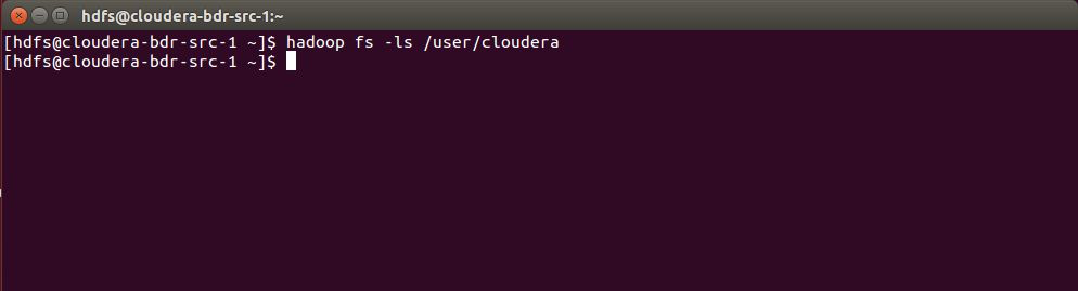

Step 3: Verify Successful Replication
Verify that the HDFS files are now on the backup cluster by using the HDFS File Browser or the hadoop fs -ls command (shown below):
The HDFS files are now on both the production cluster and the backup cluster.

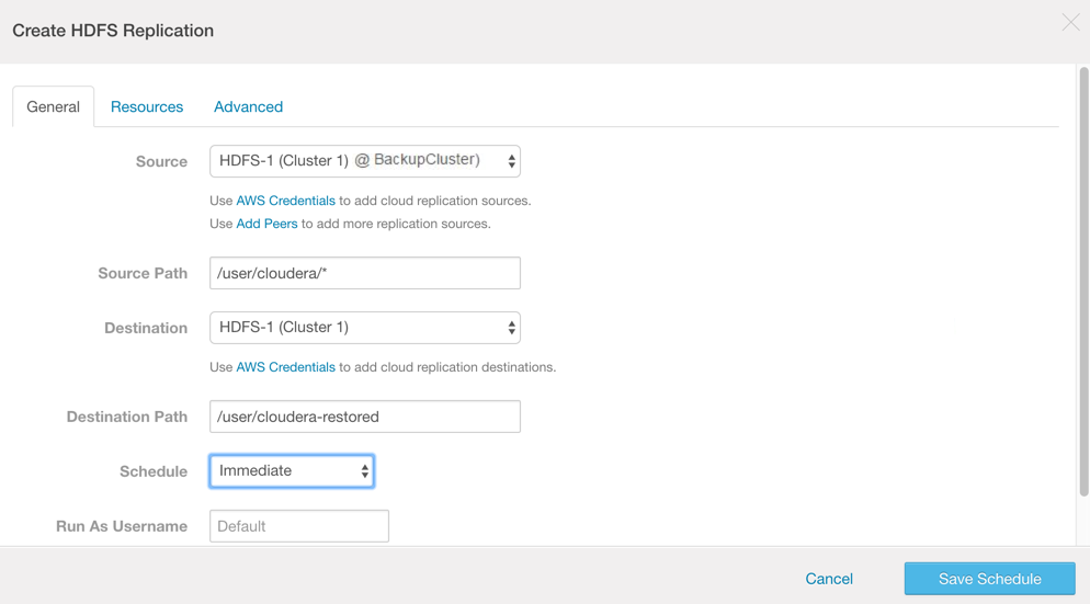

- On the General settings tab of the Create HDFS Replication page:
- Source - Make sure the cluster node selected in the drop-down is the backup cluster.
- Source Path - Specify the directory name that you want to back up. Use an asterisk (*) on the directory name to specify that only the explicit directory and no others should be created on the destination.
- Destination - Select the cluster to use as the target for the replication process.
- Schedule - Set to a time far in the future, so that the schedule does not run as soon as it is saved.

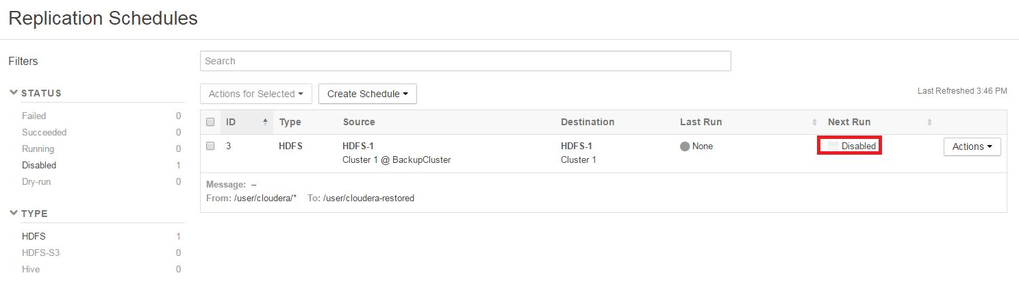

The Replication Schedule is saved and displays in the Replication Schedules list, with the future date listed in the Next Run column.
Before continuing, immediately disable this newly created Replication Schedule.
Step 3: Disable the Replication Schedule
- On the Replication Schedules page, select the replication schedule.
- From the Actions drop-down menu, select Disable. When the page refreshes, Disabled displays in the Next Run column:
You can leave restore Replication Schedules pre-configured and disabled in this way so they are ready to use in the event of a catastrophic data loss. Before relying on this approach, test the schedule.

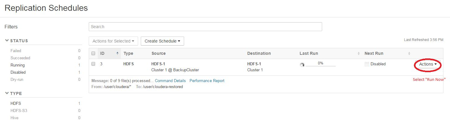

Step 4: Test the Restore Replication Schedule
The Replication Schedule defined in the example restores data to a specific directory path identified for the purpose of restoration (/user/cloudera-restored) rather than targeting the original source directory path.
From the Cloudera Manager Admin Console on the production cluster, with Replication Schedules page displayed:
- On the Replication Schedules page, select the disabled replication schedule.
- Select .
When the replication process completes, disable the Replication Schedule once again:
- Select .

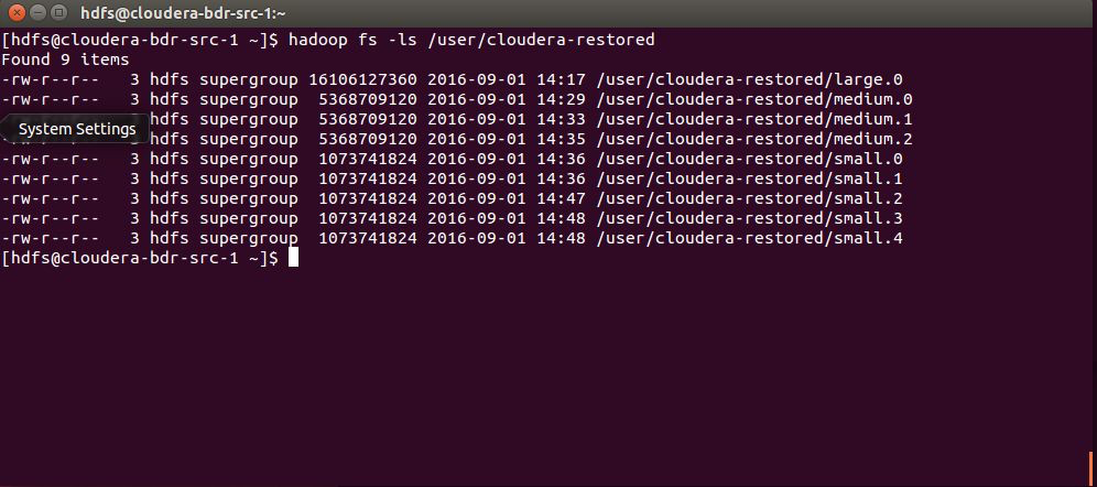

You can now verify that the files have been replicated to the destination directory path.
Step 5: Verify Successful Data Restoration
To manually verify that your data has been restored to the source cluster, you can use the HDFS File Browser or the hadoop command-line, as shown here:
Compare the restored data in /user/cloudera-restored to the data in /user/cloudera to validate that the restore schedule operates as expected.

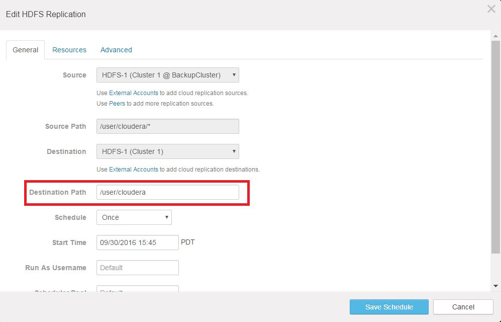

- Source - Name of the backup cluster from which to pull the data. For this example, the source is the backup cluster.
- Source Path - The path on the backup cluster that contains the data you want to restore. Use the asterisk (*) at the end of the directory name to prevent extraneous sub-directories being created on the destination.
- Destination - The name of the cluster on which to restore the data, in which case, the example production cluster.
- Destination Path - Directory in which to restore the HDFS data files, in this case, the directory on the example production system.
- Schedule - Once.
- Start Time - Leave set to the future date and time that you originally defined in Step 2: Configure Replication Schedule to Test the Restore.
- Run as Username - Leave set as Default.
The settings for the Replication Schedule are saved, and the page refreshes. Because this replication schedule is currently disabled, you must actively run the schedule to restore the data.

After confirming that the schedule has been disabled—you see Disabled in the Next Run column for this schedule—but before re-enabling the backup schedule, verify that the HDFS files have been restored to the production cluster.

- At the backup cluster, log in to the Cloudera Manager Admin Console.
- Select .
- On the Replication Schedules page, select the appropriate replication schedule to back up the production cluster.
- From the Actions drop-down menu, select Enable.
