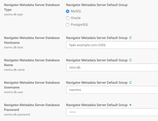

Adding the Navigator Metadata Server Role
Cloudera Manager Required Role: Navigator Administrator (or Full Administrator)
- Configure the database where policies, roles, and audit report metadata is stored. For production
environments, Cloudera supports only external databases. The internal PostgreSQL database should be used for non-production clusters only, such as proof-of-concept.
- For external databases (production environments): The database should be up and running before you add the Navigator Metadata Server role to the cluster. You must have the database schema name (user name), password, and other details to provide when adding the role. When you have these ready, you can proceed.
- For internal databases (non-production environments): No additional preliminary information is needed. You can proceed.
- Log in to the Cloudera Manager Admin Console.
- Select .
- Click the Instances tab.
- Click the Add Role Instances button. The Customize Role Assignments page displays and lists the nodes available to support additional roles, assuming the cluster has available resources. Reassign and customize role instances as needed.
- Select the Navigator Metadata Server role and assign it to appropriate host for your cluster.
- When finished, click Continue. The Database Setup page displays.
- Click Use Custom Database.
- In the Navigator Metadata Server section, enter the details of your database instance:
- Database host name
- Database type
- Database name
- Username
- Password
- Click Test Connection to verify the communication between the cluster and the external database. If the test fails, check the database settings and try again. If you selected embedded database, a message displays regarding database creation.
- Click Continue.
- The Cluster Setup Review Changes page displays.
- Click Finish.

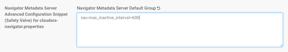

Configuring the Navigator Metadata Server Session Timeout
- Select .
- Click the Configuration tab.
- Under the Filter for Scope, click Navigator Metadata Server.
- For Filter Category, click Advanced. Scroll to find the Advanced Configuration Snippet (Safety Valve) entry field for cloudera-navigator.properties.
- Set the value for the nav.max_inactive_interval property to the number of seconds that can elapse before system times out:
nav.max_inactive_interval=num-seconds-until-timeout
This example reduces the timeout period from the default of 30 minutes to 15 minutes:
- Click Save Changes.
- Restart the Navigator Metadata Server role instance.
