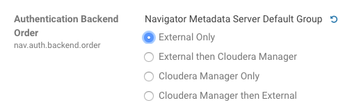

SAML authentication fails with "Cloudera Manager Only" setting
With the following combination of Cloudera Manager configuration properties set, authentication to Navigator fails:
- Authentication Backend Order: Cloudera Manager Only
- External Authentication Type: SAML
Workaround: To configure Navigator for SAML authentication, use an Authentication Backend Order other than "Cloudera Manager Only".
