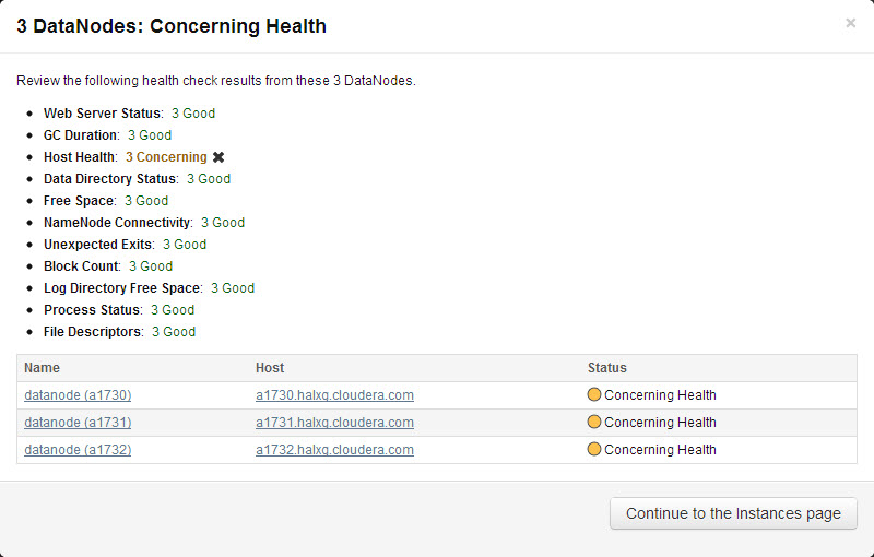

You can click either the Status link for a role to drill down to see the details of the status of the role instance(s). If there is a single instance of the role type, the link takes you directly to the role instance status.
If there are multiple role instances (such as for DataNodes, TaskTrackers, RegionServers) clicking
to the right of the role's health
displays a pop-up that allows you to select specific instances. Furthermore, this pop-up displays the results for each health test that applies to this role type.
You can filter by an individual health check result. Click the result link - an
appears by the link (as shown in the illustration above) and only the instance(s) with that specific health status will appear in the instances list.

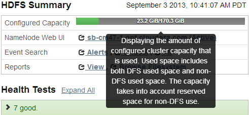

Some services (specifically HDFS, MapReduce, HBase, Flume, and ZooKeeper) provide additional statistics about their operation and performance. These are shown in a Summary panel at the left side of the page. The contents of this panel depend on the service - for example:
- The HDFS Summary shows disk space usage.
- The MapReduce Summary shows statistics on slot usage, jobs and so on.
- The Flume Summary provides a link to a page of Flume metric details. See Flume Metric Details.
- The ZooKeeper Summary provides links to the ZooKeeper role instances (nodes) as well as Zxid information if you have a ZooKeeper Quorum (multiple ZooKeeper servers).
You can hover over an individual metric to pop up a definition.
For example:
