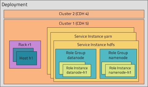

  • deployment - A configuration of Cloudera Manager and all the clusters it manages.
  • cluster - A logical entity that contains a set of hosts, a single version of CDH installed on the hosts, and the service and role instances running on the hosts. A host can belong to only one cluster.
  • host - A physical or virtual machine that runs role instances.
  • rack - A physical entity that contains a set of physical hosts typically served by the same switch.
  • service - A category of functionality within CDH. Sometimes referred to as a service type. For example: MapReduce, HDFS, YARN. It's also helpful to always remember this basic principle: Whereas in traditional environments multiple services run on one host, in CDH—and other distributed systems—a service runs on many hosts.
  • service instance - An instance of a service running on a cluster. A service instance spans many role instances. For example: "hdfs" and "yarn".
  • role - A category of functionality within a service. For example, the HDFS service has the following roles: NameNode, SecondaryNameNode, DataNode, and Balancer. Sometimes referred to as a role type.
  • role instance - An instance of a role running on a host. It typically maps to a Unix process. For example: "namenode-h1" and "datanode-h1".
  • role group - A set of configuration properties for a set of role instances.
  • host template - A set of role groups. When a template is applied to a host, a role instance from each role group is created and assigned to that host.
  • gateway - A role that designates a host that should receive a client configuration for a service when the host does not have any role instances for that service running on it.
  • parcel - A binary distribution format that contains compiled code and meta-information such as a package description, version, and dependencies.
  Note: A common point of confusion is the type-instance nature of "service" and "role". Cloudera Manager and this primer sometimes uses the same term for type and instance. For example, the Cloudera Manager Admin Console Clusters > ClusterName > Services menu actually lists service instances. This is similar to the practice in programming languages where for example the term "string" may indicate either a type (java.lang.String) or an instance of that type ("hi there"). When it's necessary to distinguish between types and instances, the word "type" is appended to indicate a type and the word "instance" is appended to explicitly indicate an instance.

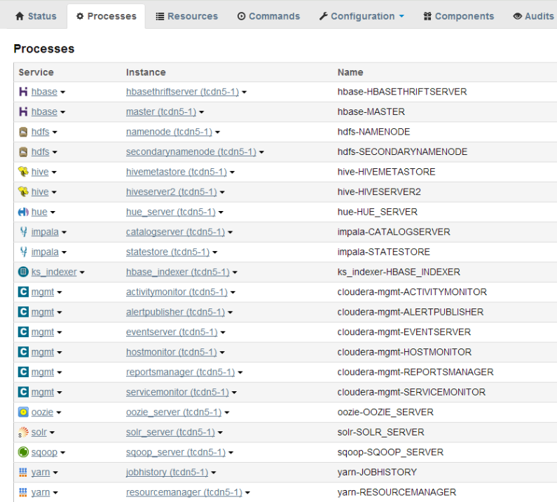

Cluster Example

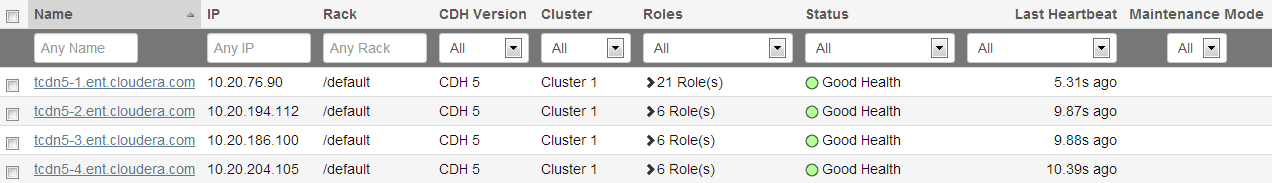

Consider a cluster Cluster 1 with four hosts as shown in the following listing from Cloudera Manager:

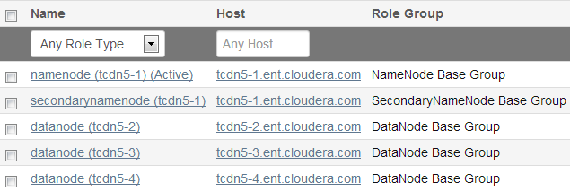

The host tcdn5-1 is the "master" host for the cluster, so it has many more role instances, 21, compared with the 6 role instances running on the other hosts. In addition to the CDH "master" role instances, tcdn5-1 also has Cloudera Management Service roles:

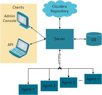

Architecture
As depicted below, the heart of Cloudera Manager is the Cloudera Manager Server. The Server hosts the Admin Console Web Server and the application logic. It is responsible for installing software, configuring, starting, and stopping services, and managing the cluster on which the services run.
The Cloudera Manager Server works with several other components:
  • Agent - installed on every host. It is responsible for starting and stopping processes, unpacking configurations, triggering installations, and monitoring the host.
  • Database - stores configuration and monitoring information. There are typically multiple logical databases running across one or more database servers. For example, the Cloudera Manager Server and the monitoring daemons use different logical databases.
  • Cloudera Repository - repository of software for distribution by Cloudera Manager.
  • Clients - are the interfaces for interacting with the server:
    • Admin Console - Web-based UI with which administrators manage clusters and Cloudera Manager.
    • API - API with which developers create custom Cloudera Manager applications.

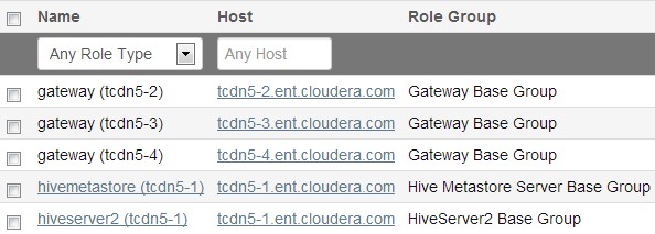

In the cluster we discussed earlier, the three hosts (tcdn5-[2-5]) that do not have Hive role instances have Hive gateways:

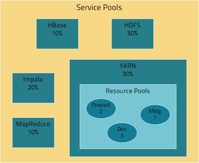

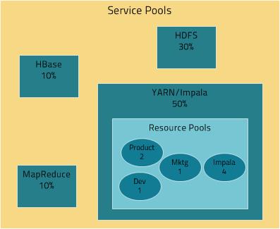

Static service pools isolate the services in your cluster from one another, so that load on one service has a bounded impact on other services. Services are allocated a static percentage of total resources—CPU, memory, and I/O weight—which are not shared with other services. When you configure static service pools, Cloudera Manager computes recommended memory, CPU, and I/O configurations for the worker roles of the services that correspond to the percentage assigned to each service. Static service pools are implemented per role group within a cluster, using Linux control groups (cgroups) and cooperative memory limits (for example, Java maximum heap sizes). Static service pools can be used to control access to resources by HBase, HDFS, Impala, MapReduce, Solr, Spark, YARN, and add-on services. Static service pools are not enabled by default.
The following figure illustrates static pools for HBase, HDFS, Impala, MapReduce, and YARN services that are respectively assigned 10%, 30%, 20%, 10%, and 30% of cluster resources. In addition, three resource pools - Dev, Product, and Mktg with weights 3, 2, and 1 respectively - are defined for YARN. If an application starts and is assigned to the Product pool, and other applications are using the Dev and Mktg pools, the Product resource pool will receive 30% x 2/6 (or 10%) of the total cluster resources. If there are no applications using the Dev and Mktg pools, the YARN Product pool will be allocated 30% of the cluster resources.
In addition, Cloudera Manager allows you to manage mechanisms for dynamically apportioning the resources statically allocated to YARN and Impala using dynamic resource pools. Depending on the version of CDH you are using, dynamic resource pools in Cloudera Manager support the following resource management (RM) scenarios:
